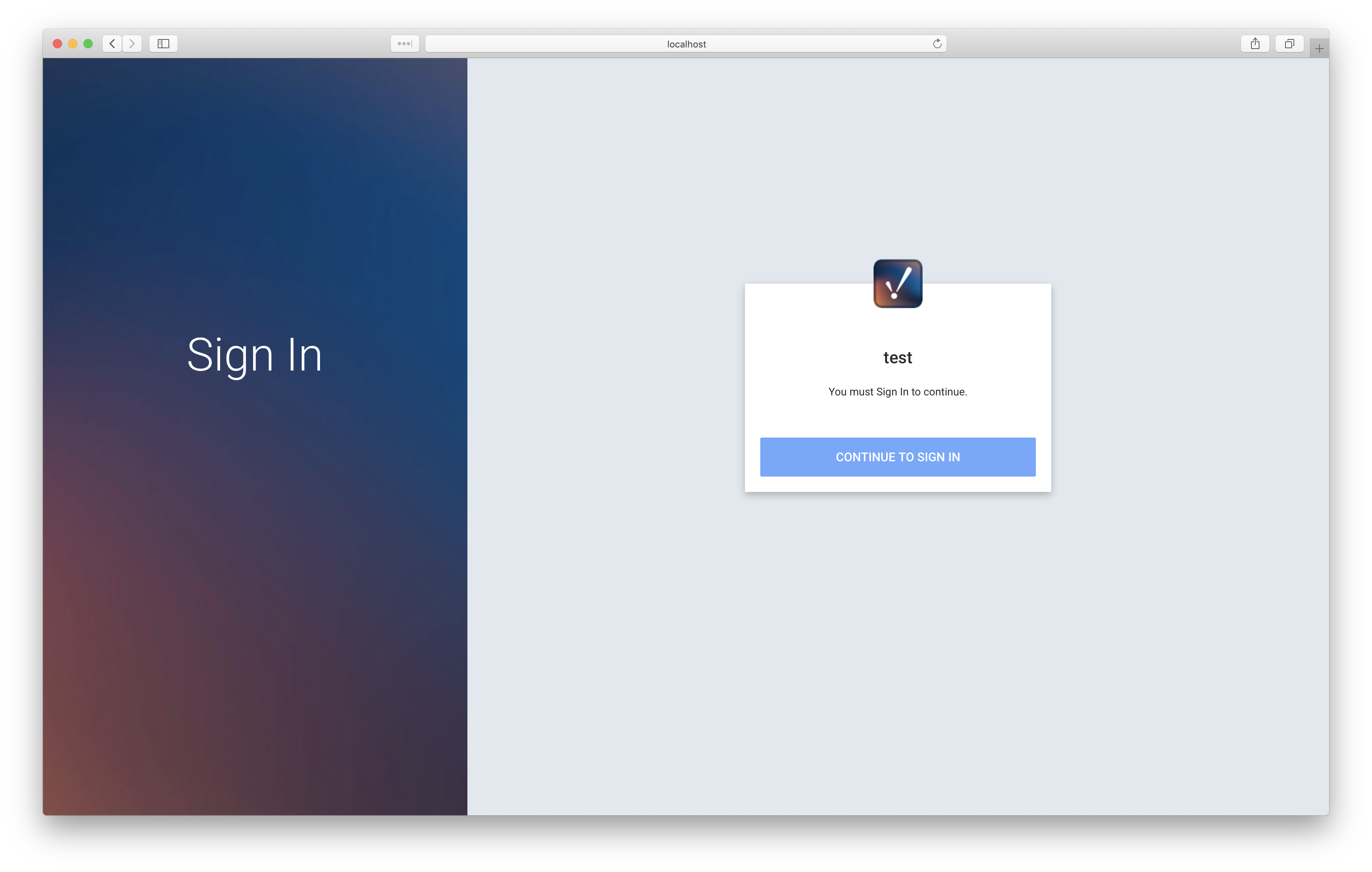

> How do I get the login page when going to a URL that requires authentication?
If your project requires the Authenticated security level or one of its descendants, you will see the following screen when trying to navigate to that project (assuming you have not logged into the project yet in the browser session):
 ![](https://us1.discourse-cdn.com/inductiveautomation/original/2X/b/b311501d8e96560bf7c1e827cf41261923aa855d.png)
Click the button labeled "Continue to Sign In" in order to go to the IdP's login page.

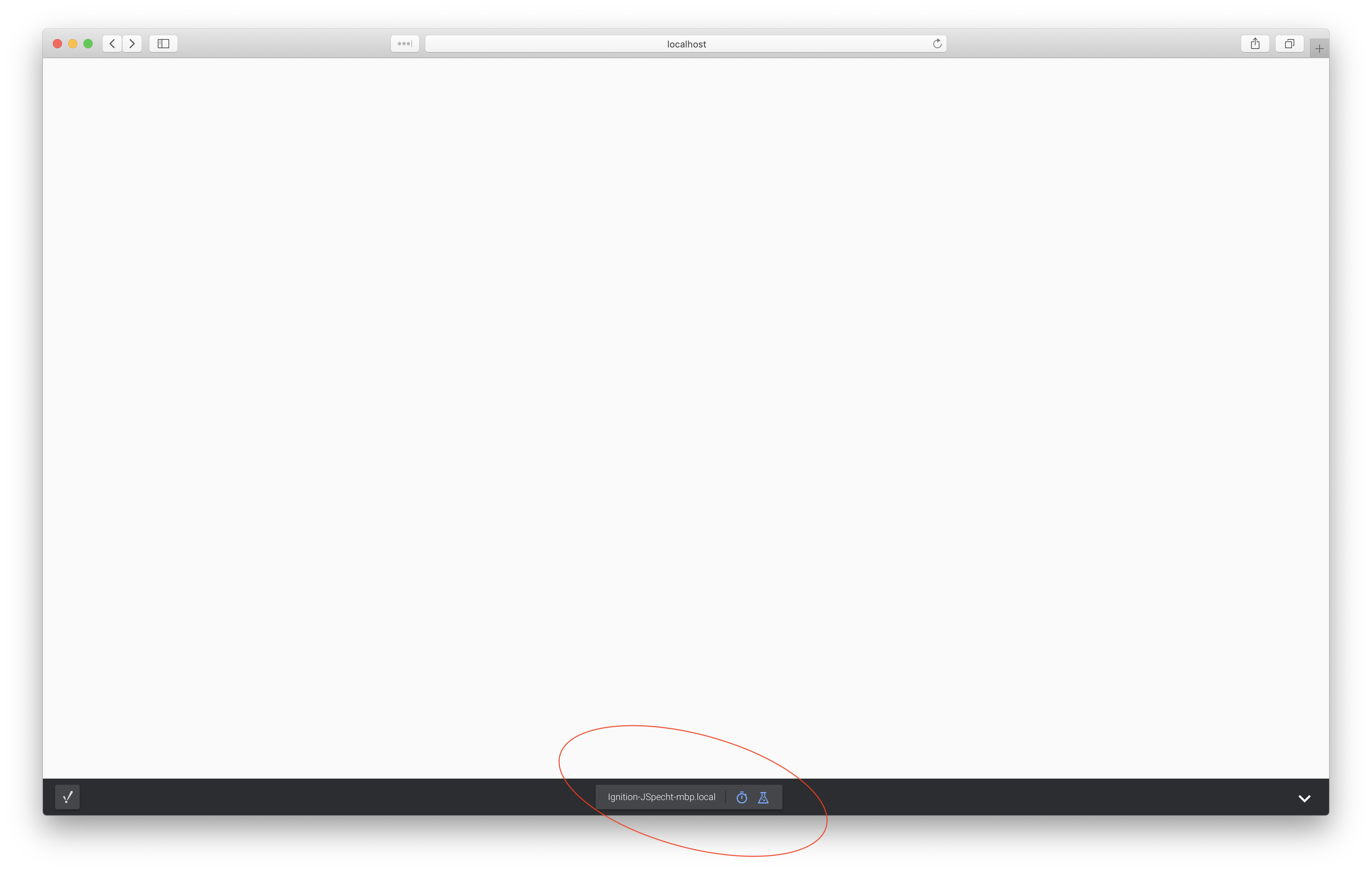

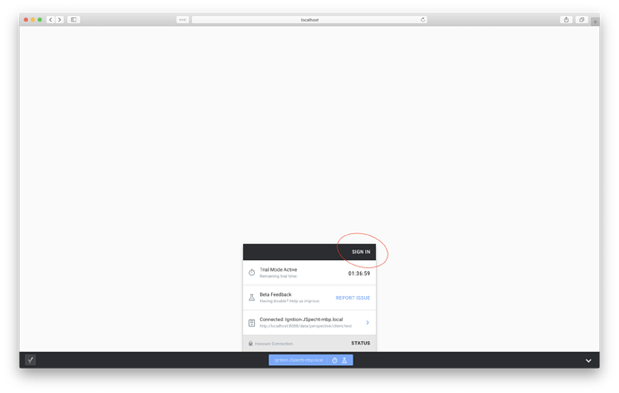

If your project does not require Authentication but one of its views or a gateway-scoped action requires Authentication, you may login by clicking the following red-circled items (from the app bar at the bottom of your perspective project):
 ![](https://us1.discourse-cdn.com/inductiveautomation/original/2X/8/85df47bad92c56198b78feed09d9959810363fc2.png)
 ![](https://us1.discourse-cdn.com/inductiveautomation/original/2X/c/c3821988fcd0ab31d8de350e712a074981cd0414.png)
 ![](https://us1.discourse-cdn.com/inductiveautomation/original/2X/4/428884263e4b3092a6bd52619262302736b77d99.png)

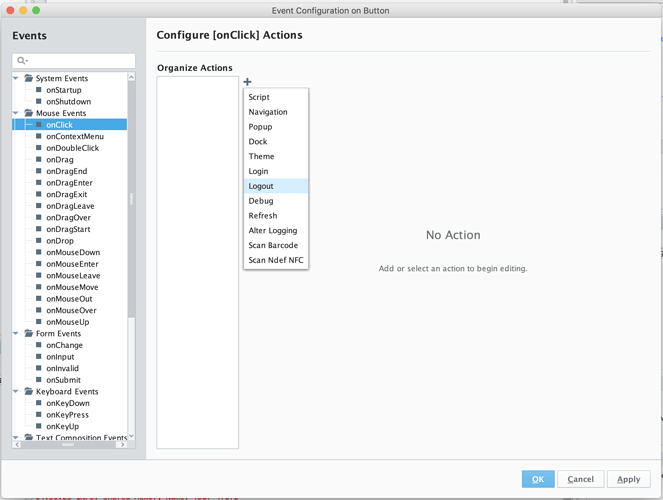

You may also configure an action to login or logout:
 ![](https://us1.discourse-cdn.com/inductiveautomation/original/2X/8/8b1d6e724358473718e38b1beb9ec1c82c8980cd.png)
You may also login or logout from a script using `system.perspective.login()` and `system.perspective.logout()`
Hope that helps!

**Author:** ![tyrel.parker](https://avatars.discourse-cdn.com/v4/letter/t/47e85d/32.png) [@tyrel.parker](https://forum.inductiveautomation.com/u/tyrel.parker)\
**Post date:** [June 20, 2019, 8:23pm UTC](https://forum.inductiveautomation.com/t/bug-authentication-in-perspective/21554/8 "2019-06-20T20:23:49Z")
I am doing something similar and having the same result where the login info isn’t being cleared from the cache when I log back in. I have been trying to find some function that I could call to manually clear it, but I haven’t been able to find it. I also am using 8.0.1 and I have a header with a button that uses the event to logout. I wish there was a reauthenticate function that I could call.
![image](https://us1.discourse-cdn.com/inductiveautomation/original/2X/6/6691228d3fcd94013e4aaa95393e4f304cf1a451.png)
**Author:** ![jspecht](https://sea1.discourse-cdn.com/inductiveautomation/user_avatar/forum.inductiveautomation.com/jspecht/32/6465_2.png) [@jspecht](https://forum.inductiveautomation.com/u/jspecht)\
**Post date:** [June 20, 2019, 9:00pm UTC](https://forum.inductiveautomation.com/t/bug-authentication-in-perspective/21554/9 "2019-06-20T21:00:45Z")
Hi @Steve_Laubach and @tyrel.parker -
When you click the logout button, is the user currently authenticated _in the perspective session_? If you invoke the logout action when the user is not currently authenticated, Perspective will not redirect the user to the IdP to clear the cached session.
**Post date:** [June 20, 2019, 10:37pm UTC](https://forum.inductiveautomation.com/t/bug-authentication-in-perspective/21554/10 "2019-06-20T22:37:56Z")
After further testing, I have found out that if I load a client for a while (10+ min probably) and then try to log out it will just log right back in as the same user. I had assumed that the authentication was good until the page was closed. If I log in and log right back out then it will re-authenticate.
**Post date:** [June 20, 2019, 11:05pm UTC](https://forum.inductiveautomation.com/t/bug-authentication-in-perspective/21554/11 "2019-06-20T23:05:38Z")
Hi @tyrel.parker -
Are you also using an Ignition IdP? Or are you using a third party IdP?
Is your project public? You can check by going to Project =\> Properties =\> Perspective =\> Permissions in the Designer.
**Post date:** [June 21, 2019, 2:36pm UTC](https://forum.inductiveautomation.com/t/bug-authentication-in-perspective/21554/12 "2019-06-21T14:36:57Z")
@jspecht We are using the Ignition IdP, and the project is authenticated.
![image](https://us1.discourse-cdn.com/inductiveautomation/original/2X/3/3d0b05c24a84e84bd08d75d23a3a5b770179ccf9.png)
**Post date:** [June 21, 2019, 4:15pm UTC](https://forum.inductiveautomation.com/t/bug-authentication-in-perspective/21554/13 "2019-06-21T16:15:41Z")
Hi @tyrel.parker -
Do you know how to capture network activity from chrome dev tools? If you could record the network activity while you replicate the issue and PM me the .har file this may help me understand what is going on. Just make sure to use a dummy account so that you do not share credentials with me 🙂
Otherwise, I would call into support so that they can take a deeper look at what’s going on in your system.
**Post date:** [June 21, 2019, 5:34pm UTC](https://forum.inductiveautomation.com/t/bug-authentication-in-perspective/21554/14 "2019-06-21T17:34:21Z")
I don’t know why I didn’t think of looking at the dev tools earlier. It turns out that our server was hitting max thresholds and having a clock drift which was causing all sorts of issues which I believe is the cause. I’ll let you know if I find a different reason.
