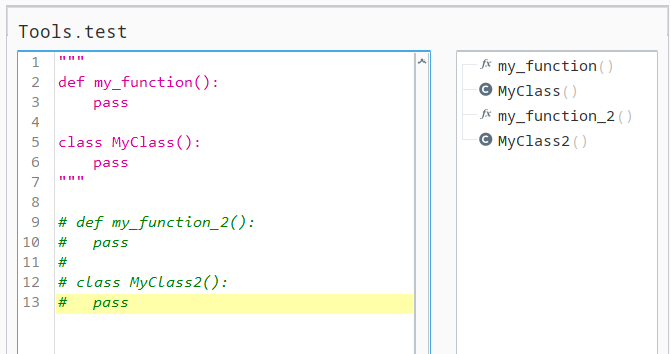

I am not really sure if this is a bug, but I wouldn't expect this behaviour.
I noticed functions and classes defined inside a comment appear in the list to the right of the scripting window.
 ![image](https://us1.discourse-cdn.com/inductiveautomation/original/3X/9/8/9879c61c2aca87bba689c097fe541b64e8a6f40d.png)
I have seen this issue in Ignition 8.1.18 and in Ingition Edge 8.1.32
**Post date:** [February 6, 2024, 4:13pm UTC](https://forum.inductiveautomation.com/t/bug-functions-and-classes-appear-in-the-list-even-if-inside-a-comment/85306/2 "2024-02-06T16:13:09Z")
I would guess that the parsing is a bit naïve in respect to what is a Doc String, what is a comment, and what is actual syntax.
@paul-griffith would be able to say for certain.
Definitely agree that its not "expected" behavior.
**Post date:** [February 6, 2024, 5:07pm UTC](https://forum.inductiveautomation.com/t/bug-functions-and-classes-appear-in-the-list-even-if-inside-a-comment/85306/3 "2024-02-06T17:07:34Z")
The current parsing that populates that sidebar is just some fairly naive regex based parsing that's very easy to break. It's long been on my list to replace it with a proper AST based parse, like what populates the actual autocomplete, but it hasn't risen to the top of the pile.
I'm hoping to tackle it as part of a suite of scripting related improvements in 8.3.0.
