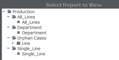

I noticed this behavior when importing reports and a viewer screen vision window from a 7.9.12 project into an 8.1.1 project. It appears that the ‘Text’ column value is concatenated into the ‘Path’ value, such that if the results are pulled into a tree view component, each report item actually appears like a folder, with a copy of itself (with an improperly extended/duplicated path) as the underlying node.

And the resulting tree view looks as it should:
 ![image](https://us1.discourse-cdn.com/inductiveautomation/original/3X/4/9/497a87c9a576e6460b9c3fb12627563416a7e2a3.png)
But in the 8.1.1 project, the same window and bindings come up like this:
 ![image](https://us1.discourse-cdn.com/inductiveautomation/original/3X/e/3/e39233478a0b45d252dad6efeecc39963d7ce0f1.png)
This causes the report viewer, which I have bound to the selectedPath of the tree view, to not work properly.

**Author:** ![KathyApplebaum](https://sea1.discourse-cdn.com/inductiveautomation/user_avatar/forum.inductiveautomation.com/kathyapplebaum/32/7261_2.png) [@KathyApplebaum](https://forum.inductiveautomation.com/u/KathyApplebaum)\
**Post date:** [December 22, 2020, 3:25pm UTC](https://forum.inductiveautomation.com/t/bug-ign-1426-system-report-getreportnamesasdataset-formats-report-path-incorrectly/41708/2 "2020-12-22T15:25:04Z")
I think this isn’t a change in the scripting function so much as the change in how resources are stored. In 7.x, the name of a resource was store separately from the rest of the path, and the scripting function returned those two separate parts to you.
In 8.x, the name of the resource is part of the path, which is what you’re getting returned.
I can see an argument for both ways – I’ll file a ticket asking to add an option to chose, since we can strip out the last element of that path before returning it to you. (You can also do this in Jython yourself, but obviously it’s easier to just add a Boolean param to your scripts.)
