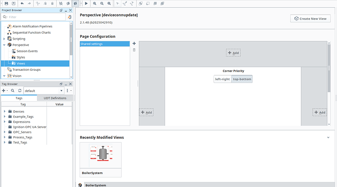

Attempting to import a project ZIP that's a subset of a valid gateway backup gives me
```python
java.lang.IllegalArgumentException: Unable to create folder path, found non-folder in the way at 'com.inductiveautomation.perspective/views/Views'
	at com.inductiveautomation.ignition.designer.project.DesignerProjectTreeImpl.insertFolders(DesignerProjectTreeImpl.java:263)
	at com.inductiveautomation.ignition.designer.project.DesignerProjectTreeImpl.insertAllLocalParentFolders(DesignerProjectTreeImpl.java:224)
	at com.inductiveautomation.ignition.designer.project.DesignerProjectTreeImpl.createResourceInternal(DesignerProjectTreeImpl.java:204)
	at com.inductiveautomation.ignition.designer.project.DesignerProjectTreeImpl.createResource(DesignerProjectTreeImpl.java:192)
	at com.inductiveautomation.ignition.designer.project.DesignableProject.createOrModify(DesignableProject.java:145)
	at com.inductiveautomation.ignition.designer.gui.import_export.ProjectImporter.lambda$doImport$2(ProjectImporter.java:311)
	at java.base/java.util.ArrayList.forEach(Unknown Source)
	at com.inductiveautomation.ignition.designer.gui.import_export.ProjectImporter.doImport(ProjectImporter.java:311)
	at com.inductiveautomation.ignition.designer.gui.import_export.ProjectImporter.lambda$new$0(ProjectImporter.java:109)
	at java.desktop/javax.swing.AbstractButton.fireActionPerformed(Unknown Source)
	at java.desktop/javax.swing.AbstractButton$Handler.actionPerformed(Unknown Source)
	at java.desktop/javax.swing.DefaultButtonModel.fireActionPerformed(Unknown Source)
	at java.desktop/javax.swing.DefaultButtonModel.setPressed(Unknown Source)
	at java.desktop/javax.swing.plaf.basic.BasicButtonListener.mouseReleased(Unknown Source)
	at java.desktop/java.awt.Component.processMouseEvent(Unknown Source)
	at java.desktop/javax.swing.JComponent.processMouseEvent(Unknown Source)
	at java.desktop/java.awt.Component.processEvent(Unknown Source)
	at java.desktop/java.awt.Container.processEvent(Unknown Source)
	at java.desktop/java.awt.Component.dispatchEventImpl(Unknown Source)
	at java.desktop/java.awt.Container.dispatchEventImpl(Unknown Source)
	at java.desktop/java.awt.Component.dispatchEvent(Unknown Source)
	at java.desktop/java.awt.LightweightDispatcher.retargetMouseEvent(Unknown Source)
	at java.desktop/java.awt.LightweightDispatcher.processMouseEvent(Unknown Source)
	at java.desktop/java.awt.LightweightDispatcher.dispatchEvent(Unknown Source)
	at java.desktop/java.awt.Window.dispatchEventImpl(Unknown Source)
	at java.desktop/java.awt.EventQueue.dispatchEventImpl(Unknown Source)
	at java.desktop/java.awt.EventQueue$4.run(Unknown Source)
	at java.base/java.security.AccessController.doPrivileged(Unknown Source)
	at java.base/java.security.ProtectionDomain$JavaSecurityAccessImpl.doIntersectionPrivilege(Unknown Source)
	at java.desktop/java.awt.EventQueue$5.run(Unknown Source)
	at java.desktop/java.awt.EventQueue.dispatchEvent(Unknown Source)
	at java.desktop/java.awt.EventDispatchThread.pumpOneEventForFilters(Unknown Source)
	at java.desktop/java.awt.EventDispatchThread.pumpEventsForFilter(Unknown Source)
	at java.desktop/java.awt.EventDispatchThread.pumpEventsForHierarchy(Unknown Source)
	at java.desktop/java.awt.EventDispatchThread.pumpEvents(Unknown Source)
	at java.desktop/java.awt.EventDispatchThread.run(Unknown Source)
Ignition v8.1.48 (b2025042910)
Java: Azul Systems, Inc. 17.0.14
the project itself is valid (if i put it into a gwbk it loads fine)

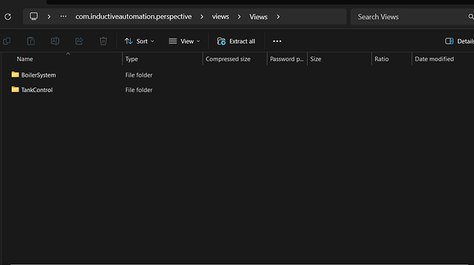

Here's the filestructure:
 ![image](https://us1.discourse-cdn.com/inductiveautomation/original/3X/0/d/0d9dd10e6b20775e08fbc992ecff301be2f61c97.png)
(Views is separate from Components which is e.g. where embedded views go)
I know the project is valid bc if i put it in the right projects folder of a gateway backup, it deserializes with no issue/error. (Which is weird, since it suggests that project serdes for import project and the spawned project serdes for gateway restores are different codepaths)

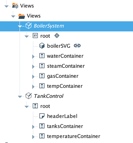

ok when i save the project _after_ that error, i do end up somehow with a perspective window loaded (Boilersystem) but it's not accessible from the sidebar:
 ![image](https://us1.discourse-cdn.com/inductiveautomation/original/3X/b/3/b3a1b6cdcee844945b6be06037125caba474e135.png)
Boilersystem is there, but Views doesn't click into anything???

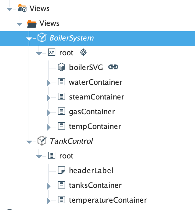

**Post date:** [June 17, 2025, 11:06pm UTC](https://forum.inductiveautomation.com/t/bug-importing-perspective-projects-in-8-1/107497/4 "2025-06-17T23:06:41Z")
Seems to work for me? 🤷
With or without an existing Views folder with existing views in it.
 ![image](https://us1.discourse-cdn.com/inductiveautomation/original/3X/b/a/ba542cb326f5b60586a39a94d0479bdbe2f8e8c5.png)
