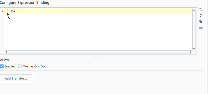

Been mucking around and noticed that if you press “tab” whilst configuring an expression binding in designer my cursor won’t move even though a Tab has been added. It sounds weird but bare with me I’ll try to explain, attached below is an image of me configuring an Expression Binding, I have pressed tab and then typed “Hi”:
 ![image](https://us1.discourse-cdn.com/inductiveautomation/original/3X/9/a/9a36a231acbcaa2f791d4df381736217577f60cc.png)
So, my cursor position is shown in the above screenshot and nothing exists past the point of my cursor indicated, the editor believes that the cursor is behind the “ _i_ ” in “ _Hi_ ”, i.e. if I press backspace I will remove the “ _i_ ” in “ _Hi_ ”.

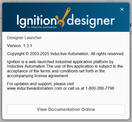

**Do note that this only happens on my monitor which I have set to over 100% Scaling on Windows (screenshot taken on a 1440p monitor at 125% scaling).** This is in the latest Ignition Designer (v1.3.1) and I don’t recall seeing this in any earlier versions.

> [@MG3](#):
This bug has been present for a long time actually. From experience, this should only affect _expression_ editors, not the scripting/SQL editors you see elsewhere in the designer; ultimately it's caused by a bug in a third party library. The fix is to swap over our implementation to a different third party library (the one used by the script editors) but other work has always taken priority. Thanks for the report, though!
