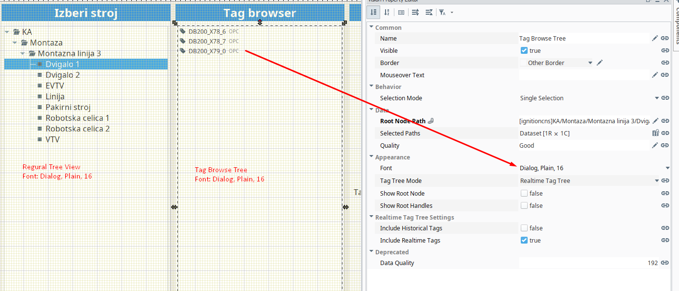

I just found out, that the Tag Browse Tree component in Vision, v8.1.11 doesn’t respect font settings:
 ![TagBrowserTree_font](https://us1.discourse-cdn.com/inductiveautomation/original/3X/2/f/2fb1c6243a8c720baa811e529119b46272d89288.png)
It doesn’t matter what you set the font to, it will not change.
It always stays, I think, on Dialog, Plan, 12.

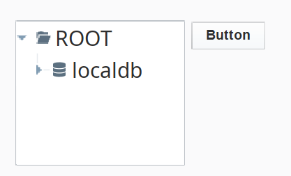

Yeah you’re right. The thing is not working. The best I could get is changing font size ONLY in _Historical Tag Tree_.
 ![image](https://us1.discourse-cdn.com/inductiveautomation/original/3X/5/6/56521031806f9ad6992f3b1c3b7b89dda056fa45.png)
BUT I don’t why the thing is not changing for RealTime tags mode.
From a button I did
```auto
component = event.source.parent.getComponent('Tag Browse Tree')
JTree = component.getTree()
font = component.font.deriveFont(20.0)
JTree.setFont(font) #Change size in history mode
component.setFont(font) #attempt to change font
tagBrowseTree = component.getComponent(0).getView()
cellRenderer = tagBrowseTree.getCellRenderer()
cellRenderer.setFont(font)
tagBrowseTree.setCellRenderer(cellRenderer) #This should set new font size, but is not working
The property Font in the component is useless. That is something that never worked.
