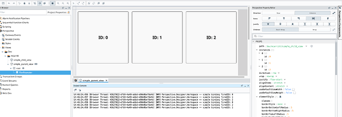

this was driving me crazy in a much more complex flex repeater + instance, but here is the most simplest , reproducible example:
There is a Parent view with flex repeater. the flex repeater instance passes a parameter “id” to the child view. instances is just static data, it doesnt change.
 ![Screenshot 2025-12-02 at 14.46.44](https://us1.discourse-cdn.com/inductiveautomation/original/3X/9/5/95817908b129862e6d33740127c641cdb3332b33.png)
The child view has a binding on the view.params.id .The binding also prints to console that it fired and the id number.
 ![image](https://us1.discourse-cdn.com/inductiveautomation/original/3X/b/3/b30749fb4a33e64dc8d6c3c8a3968107304dca46.jpeg)
As you can see in the console in the screenshot every time this parent view starts up, i **n each child the binding fires 2x.** the same result shows in the designer and the browser.
This is driving me a bit crazy in particular if I want to have a tag history binding on the child view, and its firing multiple times per instance, putting more load on the server/database than necessary. I already tried having the tag history query on the parent, but this is not ideal, I dont want users to wait to see the rest of the child view while tag history data is fetching.
I tested this with the same result on 8.1.44 and 8.3.2-rc2
