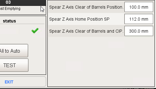

UPs on the right, this device HAS UPs:
 ![image](https://us1.discourse-cdn.com/inductiveautomation/original/2X/1/165be5ff75ca7cba92c5925fe3880cf25b4c63ad.png)

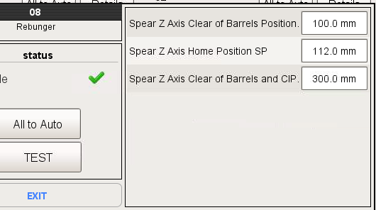

This device doesn’t have any, but the UPs from the previous device are shown:
 ![image](https://us1.discourse-cdn.com/inductiveautomation/original/2X/9/98b5a77c9369645245fa780c01e0fecc64706286.png)
the templateParams dataset reported by a print statement is: `Dataset [0R ? 4C]`

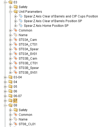

Note: 03 has Unit Parameter tags, 08 doesn’t.
 ![image](https://us1.discourse-cdn.com/inductiveautomation/original/2X/1/164d5617725d8ebfe608c8d8262b7b8fa5386832.png)
