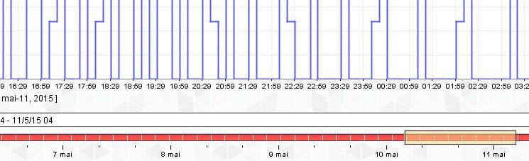

Hi everybody,
When I use an easy chart, time axis show this time format xx:59 and xx:29. Can we resolve this problem to have rounded time like xx:00 and xx:30 ?
Thanks,
 ![](https://us1.discourse-cdn.com/inductiveautomation/original/2X/c/c357293aaf41c03294f50f7093fddb1ebf9bd696.JPG)

Can you post a small, self-contained project that does this? That way we can see what the problem is. Thanks!

Here the exemple.proj file. I hope it will help you.
Thanks,
[exemple.proj](https://us1.discourse-cdn.com/inductiveautomation/original/2X/d/dbb03d80d6ad301e77301587fe9fb957483fe3a4.proj) (30.1 KB)
**Author:** ![KathyApplebaum](https://sea1.discourse-cdn.com/inductiveautomation/user_avatar/forum.inductiveautomation.com/kathyapplebaum/32/7261_2.png) [@KathyApplebaum](https://forum.inductiveautomation.com/u/KathyApplebaum)\
**Post date:** [May 13, 2015, 2:32pm UTC](https://forum.inductiveautomation.com/t/bug-time-axis-in-easy-chart/9999/4 "2015-05-13T14:32:21Z")
Thanks. I was able to reproduce this, and put in a bug ticket. In the mean time, I noticed that if I change the start time from 12:00 to 12:01, the ticks are what you expect. That may help you for now.
