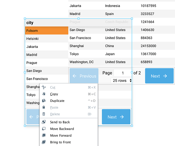

This is with MacOS Mojave, used for traditional 7.9 Designers too, FYI. There are (seemingly) massive problems with views on this platform. Keep creating views, they don’t re-open, can’t switch between breakpoints, etc etc. And simpler issues- for example, no way to delete a component. See screenshot. LMK if you need more info. GW is running in the cloud on an Ubuntu Linux host.

Update: I installed the latest. Perspective was available again, when I tried to open a previously created view, it timed out again (swirling pinwheel) for a few minutes before giving up. Then I created a new coordinate view with a simple non-dynamic tank on it, and tried to save. As you can see from the screenshot, I don’t think it is saving the view at all, actually- see message in lower left, and the view I created is not even open, but shows open in the tree.
