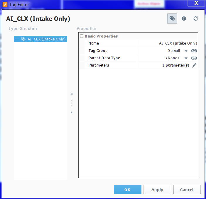

The export only has the single parameter in it:
  <Parameters>
     <Property name="PLC" type="String">WIMRP_Main_PLC</Property>
  </Parameters>
What version of the application was the export generated from? I am leaning toward this being an issue with the existing application exporting XML, but would like to confirm I can replicate.

I have attempted to duplicate this issue in 7.9, but I have been successful yet. Once point of clarification, in the screenshots the name of the UDT Definition is **Level Config** but in the import file you provided the UDT Definition is **AI\_CLX (Intake Only)**. I just want to double check the file is being generated from a tag with the same parameters.
If you confirm that the UDT export is still missing any parameters upon export from 7.9.9, I ask that you contact support to have them try and narrow down reproduction steps as it is an issue with the currently released version of Ignition.
To make your data work to test with 8.0, is it possible to use a backup of the 7.9.9 gateway on this system?
