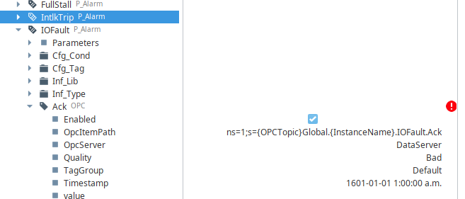

I have an OPC address i would like all the childs of my UDT to inherit. Sometimes the parameters are not properly inherited.
I see the address substituted as
ns=1;s={OPCTopic}Global.Tag01.IntlkTrip.Ack
Insted of:
ns=1;s=[TagAddress01]Global.Tag01.IntlkTrip.Ack
Picture of a member of the UDT which dont work:
 ![image](https://us1.discourse-cdn.com/inductiveautomation/original/2X/3/34b82abd23576f1dc557a66a85a1b7aafdb9717e.png)

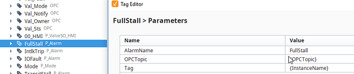

Picture of a member of the same UDT which actually work:
 ![image](https://us1.discourse-cdn.com/inductiveautomation/original/2X/5/56d77b216c3f1244ca2c7b3125592ef76559aa71.png)
Paremeter input for both child UDTs (P\_Alarm):
 ![image](https://us1.discourse-cdn.com/inductiveautomation/original/2X/f/ff67906fa0f931a22277bcd43cd0c0f9c8d43689.png)
Sidenote, i cant seem to create this bug when I create a UDT from scratch. It could be that the bugs originates from the conversion from 7.9 to 8. Anyways, I am currently not able to bypass this bug (and creating all the UDT’s from scratch would take a long time)
Nightly build (last week)

Ok, I actually found a work around last night:
For each UDT child (which is also a UDT), using passed parameters:
adding a character to each parameter
appying,
removing the character again
applying
This solved the issue,
