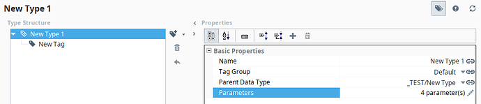

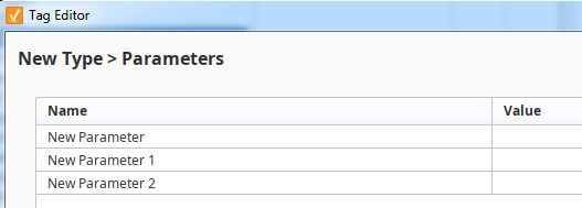

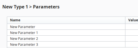

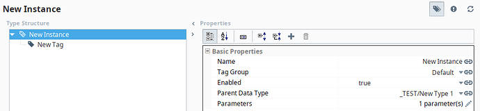

However you can easily reproduce this manually by:
1. Create new UDT with a few parameters and a tag
 ![image](https://us1.discourse-cdn.com/inductiveautomation/original/2X/e/e7ca2b7ea5835f2457799f660fb39268b59dc4d5.png)
2. Create another new UDT with the parent as step 1 UDT and add a new parameter
3. Create a UDT instance of New Type 1 (step 2 UDT)
When you create the instance, all of the parameters show:

I’m working in 8.0.1 and am having the same issue. Restarting the Gateway, and refreshing the provider doesn’t fix it.
I am unable to use parent UDTs as they only show up with one parameter in the child UDT.
