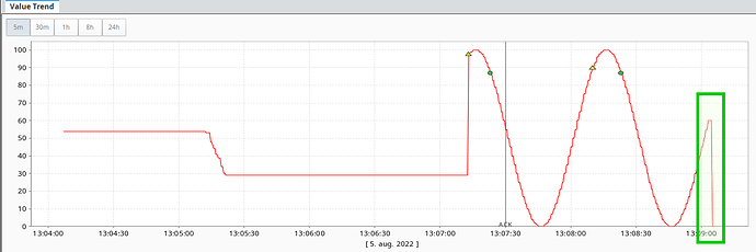

Hi, Is there a good explanation for this?
-In my opinion this is confusing if not wrong
-Is there some way of avoiding this, and let the curve end at current value, not zero?

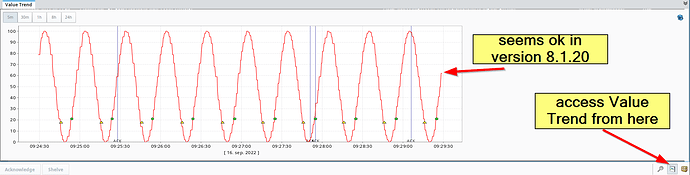

What exact version of Ignition are you running?
**Author:** ![johannes.bo](https://sea1.discourse-cdn.com/inductiveautomation/user_avatar/forum.inductiveautomation.com/johannes.bo/32/27628_2.png) [@johannes.bo](https://forum.inductiveautomation.com/u/johannes.bo)\
**Post date:** [September 16, 2022, 7:33am UTC](https://forum.inductiveautomation.com/t/bug-vision-alarm-status-table-value-trend-always-show-zero-as-current-value/62713/3 "2022-09-16T07:33:55Z")
I believe the forum post was created using version 8.1.18 (?)
I did a test just now running version 8.1.20, and it seems to work as expected
Case closed. 🙂
