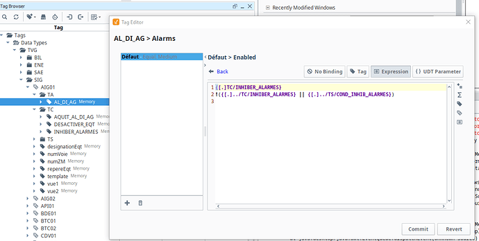

I’ve uploaded some udt def from ingnition 7.9.10 to Ignition 8.0.2-.20190509
If I edit expression inside UDT, for referencing a tag in another folder, the tag path is [.] instead of [.]…/
See example : ignition 8 insert : {[.]TC/INHIBER\_ALARMES}
See example : ignition 7.9 insert : {[.]…/TC/INHIBER\_ALARMES}
 ![expression_tag_path](https://us1.discourse-cdn.com/inductiveautomation/original/2X/1/1782e09d17473b24a32ad028bf5d50fbffae806f.png)
