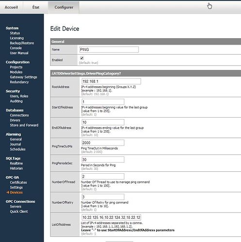

Thank you for the module update for version 7.7
Is there a little instruction available how to use the module. I already installed it but have no clue how to use it.
**Author:** ![mazeyrat](https://sea1.discourse-cdn.com/inductiveautomation/user_avatar/forum.inductiveautomation.com/mazeyrat/32/10955_2.png) [@mazeyrat](https://forum.inductiveautomation.com/u/mazeyrat)\
**Post date:** [August 18, 2014, 4:04pm UTC](https://forum.inductiveautomation.com/t/byes-apps-ping-module/8392/11 "2014-08-18T16:04:13Z")
Create a new ping device
and set parameter (list of address IP to ping (leave “-” if you use a root address with a start and end adress)
In designer, browse opc tag
 ![](https://us1.discourse-cdn.com/inductiveautomation/original/2X/2/2dec77510f9ed610c6980b52955d9508ba27deca.jpg)
