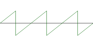

We collect information for a tank level. When the tank level reaches a specific point, we pump it out. Then the cycle repeats. The frequency is fairly constant but not exactly clockwork.
i.e. the graph looks pretty much like this.
![](https://us1.discourse-cdn.com/inductiveautomation/original/3X/8/5/85233f0c41c080fb08eb6597206c880ebeebb5a7.png)
What they would like to know is
1. The frequency of cycles from low to high within the time frame shown in the chart (they select the time frame on an easy chart)
2. The time it takes to go from low to high for each cycle.
These values will be put into a numeric display field for the # of cycles, and a table for the times between cycles.
Suggestions on the right SQL query would be greatly appreciated…
Thanks

It’s tricky unless you declare or the pump starts and stops at “exact” above and below levels
however if you log the pump running status or similar either as an event/alarm, or via a transaction group you could use that for both,
For the frequency you could count the number of runs(start) between periods, and for the time from low to high would be time period between running.
Chris

This one is tricky, but I would write a script that loops through the dataset. It looks like your values are always increasing (until they reset) so you could just grab the current and next values in a for loop and if the next value is less than the current value, then you know you are at a peak. From that you can calculate the number of peaks and time since the last peak.

Being that the value of the tank level is likely coming from an analog loop, I rather doubt that it’s a nice sawtooth waveform. What your really looking for is the time between when the pump turns off and the time the pump turns back on.
My idea is similar to Bobby’s but I’d add a column in the table to store the pump running status. Then in your loop you only need to look for the transition in the pump status. Be a lot easier to hit than minor fluctuations in the level values.
Also looking for the transitions will enable you to extract full cycles, and not have to worry about the beginning and ending data that would likely be incomplete cycle data.

ahhh, that was the problem to begin with. The pump isn’t coming into the PLC and all I had was a level.
What I chose to do, was write some PLC logic to give me a digital bit when I hit hi level and once that was stored in the database, I turn off the bit. Quick and simple and now I can query the database just looking for the the bits that are on and that gives me the timestamp I need to give the boss the info he wanted.
Thanks everyone!
