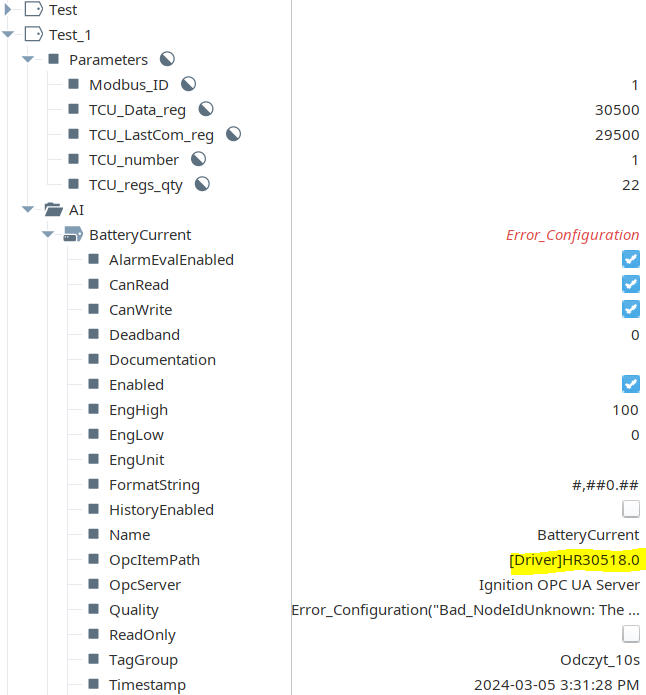

Hello,
I have created a UDT that has several parameters by which the appropriate register for modbus addressing in Tag is calculated.
When the UDT is used and I create a manual instance, I can see in the path that the address is ok. I tried to generate several instances using wizard but noticed that for the same parameters the address is different. What I mean is that the ending ".0" appears in the path.
I have no idea what it is caused by. I have tried several times to create UDT from scratch and trestart the gateway and I don't know why it keeps appearing.
Formula;
[Driver]HR{TCU\_Data\_reg+18+TCU\_regs\_qty\*(TCU\_number-1)}
UDT:

Tag 1 instance created:
 ![image](https://us1.discourse-cdn.com/inductiveautomation/original/3X/3/b/3ba7fec8401ddb64e17737ceff976dab7af87bf5.png)
Tag 2 wizard created:
 ![image](https://us1.discourse-cdn.com/inductiveautomation/original/3X/d/8/d8a4c3d0e288e3de441920709bffff03d4e792b2.png)
I noticed that in the parameters there is a difference involving the separation of thousands I also tried to enter it interchangeably and the result is different again, I do not know why?
 ![image](https://us1.discourse-cdn.com/inductiveautomation/original/3X/c/c/cc430ee8de25e8447cf9bcaebbdca16255664c01.png)
Greetings
Michał
**Post date:** [March 5, 2024, 3:04pm UTC](https://forum.inductiveautomation.com/t/calculations-on-udt-parameters-using-binding-problem/86828/2 "2024-03-05T15:04:54Z")
How are you creating the instance? Perhaps with `system.tag.configure()` ?
If so, you must not include your parameters in the `.configure` operation, but use `system.tag.writeBlocking()` afterwards. `.configure()` screws up parameter overrides, changing their data types.

I was discover that UDT instances generated using instance wizard have different type of parameters which may cause the problem. Does anyone know a solution for this?

**Post date:** [March 6, 2024, 1:08pm UTC](https://forum.inductiveautomation.com/t/calculations-on-udt-parameters-using-binding-problem/86828/5 "2024-03-06T13:08:23Z")
> [@Michal\_Goralczyk](#):
It's a bug in Ignition.
My prior comment offers a work-around: Use `.configure()` in a script without including parameters. Use `.writeBlocking()` to then set the parameters.
