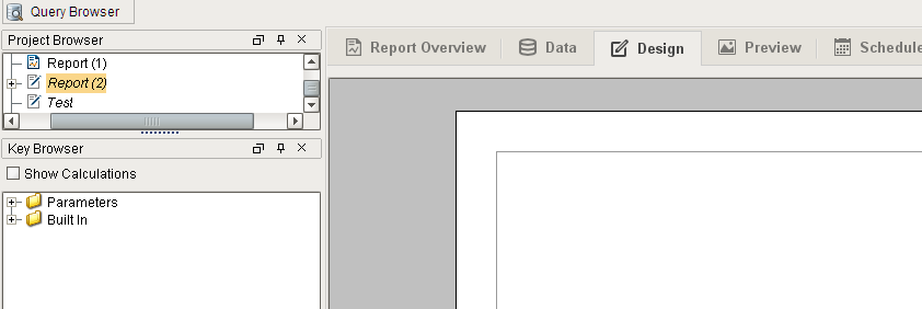

I am trying to call it in from a report. But, I am getting nowhere! I am not seeing any columns listed in the data source of my query. Can anyone see what I am doing wrong? It is supposed to be a simple call. I spent over two hours scratching my head -

Here is my code for calling the Stored Proc:
```auto
call = system.db.createSProcCall("splocal_AFL_Schedule_GetDisplay")
call.registerInParam("EquipLineName", system.db.VARCHAR, "BL07")
call.registerInParam("ReturnCode", system.db.INTEGER,0)
call.registerOutParam("ReturnMessage", system.db.INTEGER)
system.db.execSProcCall(call)
dataSource = call.getResultSet()<a class="attachment" href="//cdck-file-uploads-us1.s3.dualstack.us-west-2.amazonaws.com/inductiveautomation/original/2X/9/93ef7546b0612a2c4208eb030222b3f9c32f09a5.doc">Calling Stored Procedure From a Report.doc</a> (204.5 KB)
Thanks.
**Post date:** [March 31, 2019, 9:51pm UTC](https://forum.inductiveautomation.com/t/calling-a-stored-procedure-from-a-report-issue/23739/2 "2019-03-31T21:51:15Z")
You are trying to use scripting where Ignition is expecting a SQL Query. Use a scripting data source.
