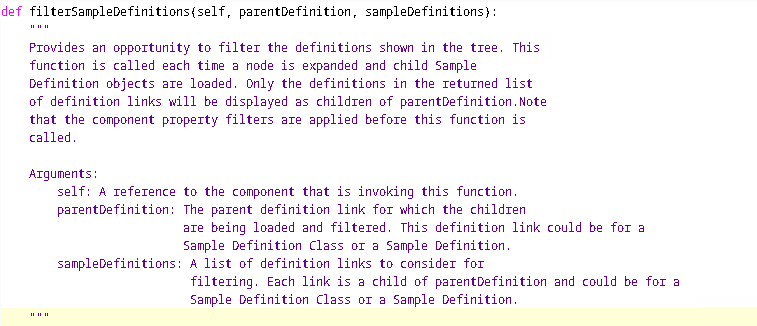

I am using Ignition v8.1.17 and Sepasoft SPC module (v3.81.5 SP1). I want to filter sample definition based on the selection of the Location. Sample Definition Manager component has a `filterSampleDefinition` extension function which returns the filtered list but it runs only when the window containing it is opened. I want to provide the option to filter list on other event like button click, dropdown option selection etc.
Is there any way to _refresh_ component to call this extension function? This method could potentially be used for other components as well.
 ![image](https://us1.discourse-cdn.com/inductiveautomation/original/3X/9/d/9dfd7ca676a2e5bd648bd2f6bac97b9c5c71f969.png)

If you need to write something that will be called in multiple spots or components, write your script in your project scripting library, and then call it from the appropriate extension functions. That’s for the code duplication part/being able to use it in other components.
Not sure what you mean regarding refreshing the component.

By refresh I mean making the component to call the extension function similar to way it does when window containing the component is opened. I am not sure if the arguments (their value) passed to the extension function by component can be obtained/created outside of the component. It might be possible to use some other functions and create these arguments but there is no property on the component which I can write the resultant filtered list to.
Instead if it is possible to trigger the call to the extension function (or rather making component to call extension function as one of the arguments is component itself), it would make it easier.

From [javadocs](https://github.com/inductiveautomation/ignition-sdk-examples/wiki/Javadocs-&-Notable-API-Changes), I found that there is `startupComponent` method that reloads the component making it to call the extension function. I tested below code on button click and it is working for above mentioned component. I think it should work for other Ignition/Sepasoft components having extension functions.
> comp = event.source.parent.getComponent('SPC Sample Definition Manager')
> appContext = comp.getAppContext()
> comp.startupComponent(appContext)
I have enabled only one extension function out of 3 available functions.
