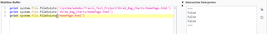

I have a Python doGet script that I'm trying to read a html file, and I’ve been trying system.file.readFileAsString and I couldn’t get it to work with the mounted path or normal path and when I try system.file.fileExists I get false on all of the paths I could think to try. so, I'm kind of loss I feel like surely there has to be a way to split up the code. I hope I'm just missing something obvious

I figured it out I needed to use system.net.httpGet() and convert to a string instead of system.file.readFileAsString()

Why in the world would you have WebDev call back into itself to retrieve the file? Horribly inefficient. Just read the file directly, using the **mount** location plus leaf path.

In your first screenshot, you see the `HomePage.html` resource under `Shred_Bag_Charts`. Look at that resource to see where **IT** is getting the file. If that resource is a simple mount, then the file path will be right there in the configuration. If that resource is a `doGet` script, you would look at what its script does, and replicate that in your `main` resource.
I strongly recommend that you have your script resources be one-liners pointing at a project library script function, passing the given arguments. That also allows you to share common code among multiple callers. Also:

it looks like you were running the `system.file.*` functions from a script console. Note that running these from the script console will attempt to access files on the machine that the Designer is running on (your PC), which is not always the gateway where the resources are hosted. In order to read a WebDev resource on the gateway from script console running on a different machine, you were correct in using a `system.net.*` function.
Put another way, your `system.file.*` functions _may_ have worked perfectly in the doGet method.
