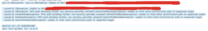

On perspective, I have to call a webservices when my view open.
I have a script who run well in the script console. But When fire from the event, I have a error message. I understand it’s a problem of certificate but I don’t know how to resolve it.
Anyone have an idea ?
 ![image](https://us1.discourse-cdn.com/inductiveautomation/original/3X/9/3/93f54c6251b3a64caba3a51e8ff73a22390c0ea8.png)
**Post date:** [August 29, 2025, 2:12pm UTC](https://forum.inductiveautomation.com/t/calling-webservice-from-view-event-failed/110275/3 "2025-08-29T14:12:58Z")
In the script console, the outgoing HTTP call is being made by your _local_ computer, wherever you're running the designer. To the operating system, it's an HTTP call made by your local _user_, since it's just a standard program running as you.
**Everywhere** in Perspective, your scripts are actually running on the Ignition gateway.
That means the outgoing HTTP call is coming from wherever Ignition is actually installed, and by default is running as a limited privilege "service" user. If the host OS is Windows, it's running as the special 'service' account `LOCAL_SYSTEM` that has limited access to external networks.
In other words: Engage with your IT department to see why the host that runs the gateway cannot reach the other resource.

I don’t think it’s a network issue. I can access to the webservice (swagger UI) from edge browser on the server.
I think I need to import a certificate somewhere in Ignition but I’m not sure where.

Problem solved.
I needed to import the server certificate in the `%gateway installation directory%data/certificates/supplemental` folder

Update.
The previously given solution worked for several months (until the certificates were renewed). The final solution was to modify the Ignition service account as @paul-griffith had suggested.
