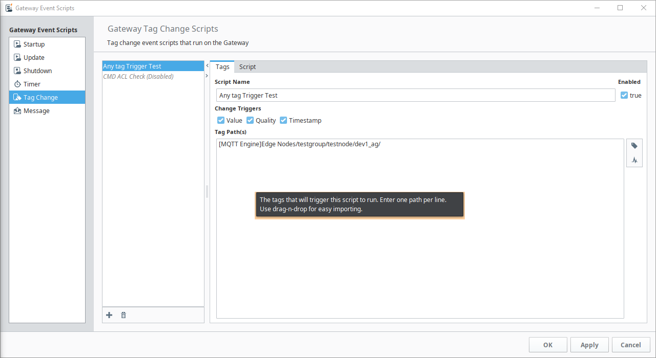

Hi,
I’d like to have a script in designer which gets triggered on all tags with a specific name (each device would have one).
Is this possible using the Gateway Event Scripts → Tag Change ?
My script triggers on a specific tag, or all tags with `[MQTT Engine]*`, but I need some kind of blanket rule or wildcard selection that allows me to trigger on a specific tag name.
Ideally I’d like to specify something along the lines of `[MQTT Engine]*/*/*/*/ExecCommand`, this did not appear to work, should it?
I’m planning to use it to filter comand requests depending on permissions.
 ![image](https://us1.discourse-cdn.com/inductiveautomation/original/3X/7/d/7d7fff2d0a5a8fd4eb6586fb557e1f2367b63d35.png)
**Post date:** [October 28, 2020, 3:22pm UTC](https://forum.inductiveautomation.com/t/can-a-script-be-triggered-on-a-specific-tag-name-tag-change-events/40085/2 "2020-10-28T15:22:26Z")
No, you can’t configure the listener that way. What you _could_ do (I’d be wary of the performance ramifications, though) is configure a broad listener, and then _immediately_ in your script do the check for the final element in the tagpath - and if it’s not found, finish execution. I’d recommend using `if event.tagPath.itemName == "ExecCommand":` or something similar.
