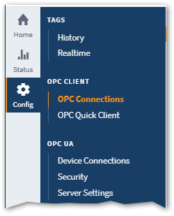

Kevin is suggesting that you enable the OPC-UA server **in the PLC**. Make a note of the settings and any security details.
In Ignition you create an OPC Connection (not a Device Connection).

What you're doing here is making Ignition a client of the OPC-UA server on the PLC. (Choose UA, not DA which is obsolete.)
