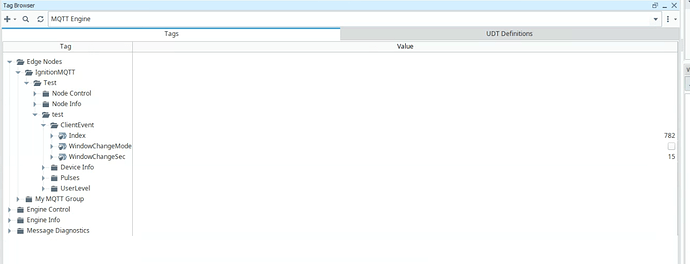

Hello everyone, I have a problem.
About MQTT Engine Tag.
I use MQTT engine 's tag.
Its source from ignition test edge 's MQTT Transmission and locol ignition server MQTT Distributo now,
and it can reading normally,but it can’t write.
I checked my MQTT Distributor’s User ACLs setting is “RW #”.
Did miss detail setting?
 ![2022-08-12 16_44_17-Chrome 遠端桌面 - ORing_NB51220601](https://us1.discourse-cdn.com/inductiveautomation/original/3X/8/4/84cc4d75ffd050d76a21801951be66261c4491ba.png)

check on the gateway config page for engine “Block Node Commands” and “Block Device Commands”.

thank you!!
I success
