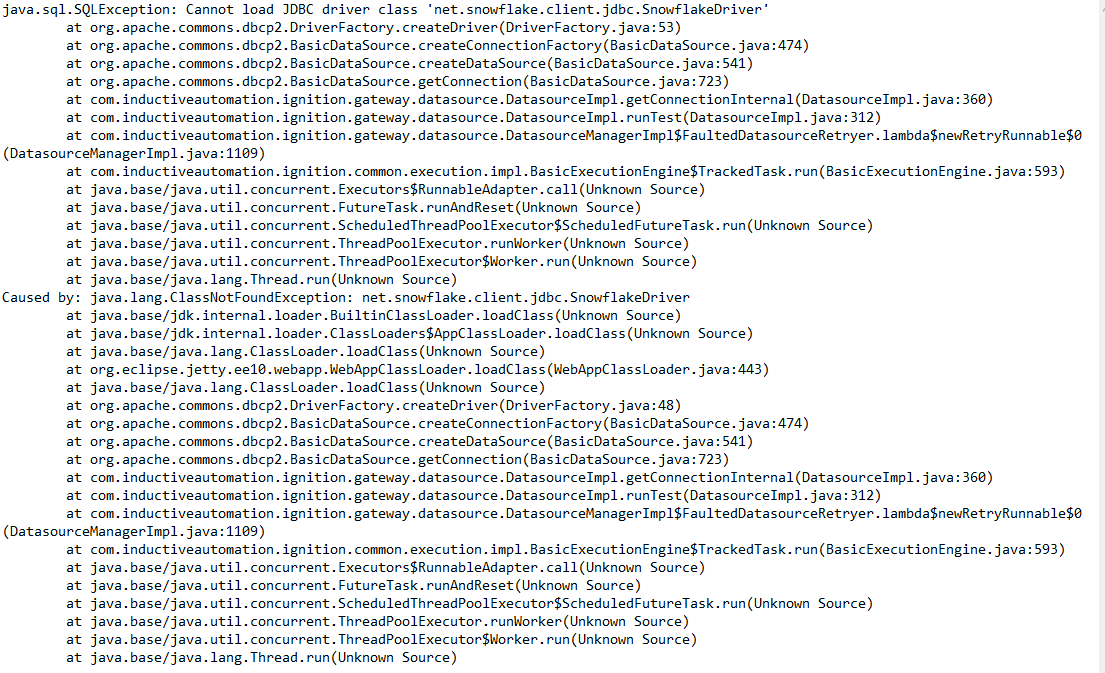

Here is the full stack trace of the error found on the Database Connection:
java.sql.SQLException: Cannot load JDBC driver class 'net.snowflake.client.jdbc.SnowflakeDriver' at org.apache.commons.dbcp2.DriverFactory.createDriver(DriverFactory.java:53) at org.apache.commons.dbcp2.BasicDataSource.createConnectionFactory(BasicDataSource.java:474) at org.apache.commons.dbcp2.BasicDataSource.createDataSource(BasicDataSource.java:541) at org.apache.commons.dbcp2.BasicDataSource.getConnection(BasicDataSource.java:723) at com.inductiveautomation.ignition.gateway.datasource.DatasourceImpl.getConnectionInternal(DatasourceImpl.java:360) at com.inductiveautomation.ignition.gateway.datasource.DatasourceImpl.runTest(DatasourceImpl.java:312) at com.inductiveautomation.ignition.gateway.datasource.DatasourceManagerImpl$FaultedDatasourceRetryer.lambda$newRetryRunnable$0(DatasourceManagerImpl.java:1109) at com.inductiveautomation.ignition.common.execution.impl.BasicExecutionEngine$TrackedTask.run(BasicExecutionEngine.java:593) at java.base/java.util.concurrent.Executors$RunnableAdapter.call(Unknown Source) at java.base/java.util.concurrent.FutureTask.runAndReset(Unknown Source) at java.base/java.util.concurrent.ScheduledThreadPoolExecutor$ScheduledFutureTask.run(Unknown Source) at java.base/java.util.concurrent.ThreadPoolExecutor.runWorker(Unknown Source) at java.base/java.util.concurrent.ThreadPoolExecutor$Worker.run(Unknown Source) at java.base/java.lang.Thread.run(Unknown Source) Caused by: java.lang.ClassNotFoundException: net.snowflake.client.jdbc.SnowflakeDriver at java.base/jdk.internal.loader.BuiltinClassLoader.loadClass(Unknown Source) at java.base/jdk.internal.loader.ClassLoaders$AppClassLoader.loadClass(Unknown Source) at java.base/java.lang.ClassLoader.loadClass(Unknown Source) at org.eclipse.jetty.ee10.webapp.WebAppClassLoader.loadClass(WebAppClassLoader.java:443) at java.base/java.lang.ClassLoader.loadClass(Unknown Source) at org.apache.commons.dbcp2.DriverFactory.createDriver(DriverFactory.java:48) at org.apache.commons.dbcp2.BasicDataSource.createConnectionFactory(BasicDataSource.java:474) at org.apache.commons.dbcp2.BasicDataSource.createDataSource(BasicDataSource.java:541) at org.apache.commons.dbcp2.BasicDataSource.getConnection(BasicDataSource.java:723) at com.inductiveautomation.ignition.gateway.datasource.DatasourceImpl.getConnectionInternal(DatasourceImpl.java:360) at com.inductiveautomation.ignition.gateway.datasource.DatasourceImpl.runTest(DatasourceImpl.java:312) at com.inductiveautomation.ignition.gateway.datasource.DatasourceManagerImpl$FaultedDatasourceRetryer.lambda$newRetryRunnable$0(DatasourceManagerImpl.java:1109) at com.inductiveautomation.ignition.common.execution.impl.BasicExecutionEngine$TrackedTask.run(BasicExecutionEngine.java:593) at java.base/java.util.concurrent.Executors$RunnableAdapter.call(Unknown Source) at java.base/java.util.concurrent.FutureTask.runAndReset(Unknown Source) at java.base/java.util.concurrent.ScheduledThreadPoolExecutor$ScheduledFutureTask.run(Unknown Source) at java.base/java.util.concurrent.ThreadPoolExecutor.runWorker(Unknown Source) at java.base/java.util.concurrent.ThreadPoolExecutor$Worker.run(Unknown Source) at java.base/java.lang.Thread.run(Unknown Source)

It’s in the middle of that stack trace post, but here it is a an image if it makes it easier to decipher:
I can see that in the Caused By section there is a ClassNotFoundException which is firing, but I don’t know enough how to rectify it unfortunately.

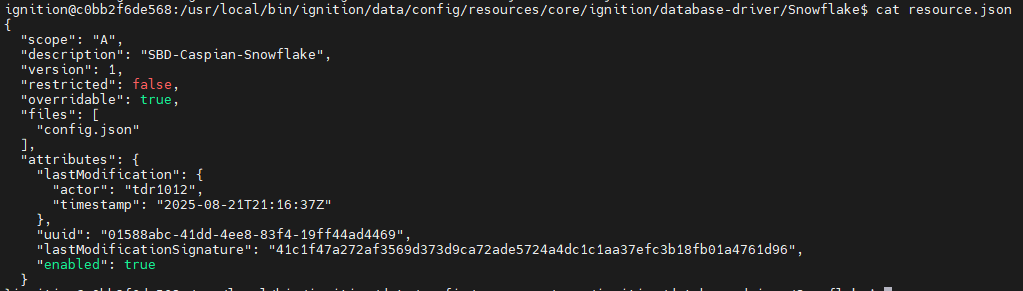

**Author:** ![Tim\_Ryder](https://avatars.discourse-cdn.com/v4/letter/t/4bbf92/32.png) [@Tim\_Ryder](https://forum.inductiveautomation.com/u/Tim_Ryder)\
**Post date:** [August 22, 2025, 2:24pm UTC](https://forum.inductiveautomation.com/t/cannot-load-jdbc-driver-class-net-snowflake-client-jdbc-snowflakedriver/110076/11 "2025-08-22T14:24:19Z")
resource.json
 ![image](https://us1.discourse-cdn.com/inductiveautomation/original/3X/7/1/71255b6b1997ee530fd8641da27da3364c23d51b.png)
config.json
 ![image](https://us1.discourse-cdn.com/inductiveautomation/original/3X/4/e/4e566560beffa925c8f39166720c5b634b284050.png)
These match what I SET in the UI and also what I am currently seeing.
**Post date:** [August 22, 2025, 2:27pm UTC](https://forum.inductiveautomation.com/t/cannot-load-jdbc-driver-class-net-snowflake-client-jdbc-snowflakedriver/110076/12 "2025-08-22T14:27:19Z")
I think that "files" array in `resource.json` may need an entry that matches the JAR file name?
Presumably this is all handled by the Gateway when the UI workflow doesn't fail due to the file size...

resource.json:
```python
  "scope": "A",
  "description": "",
  "version": 1,
  "restricted": false,
  "overridable": true,
  "files": [
    "config.json",
    "snowflake-jdbc-3.26.0.jar"
  "attributes": {
    "lastModification": {
      "actor": "<IGNITION_USER>",
      "timestamp": "2025-08-22T14:13:01Z"
    "uuid": "6f7f1abc-f9ee-47e9-9ba7-29e5ce828608",
    "lastModificationSignature": "c00060d211ed9a6f4ea287003e26933ec8744ff56922ea0de3da18460ace9a99",
    "enabled": true
driver directory overview:

Alright, so I was finally successful.
I ended up having to modify the resource.json file outside of the docker container and put it back in. Then I logged into the container with bash and performed a chown command to the json to make sure it matches the already there config.json owner:group.
Once I did this for the “/usr/local/bin/ignition/data/config/resources/core/ignition/database-connection/CONNECTIONNAMEFOLDER” and also to the “/usr/local/bin/ignition/data/config/resources/core/ignition/database-driver/DRIVERNAMEFOLDER” path, I was finally able to load the resource.
Also note: I modified both “web.xml” files accordingly
