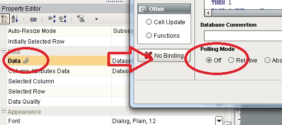

I have been getting what I think should be a simple solution, but is just beyond my sight. I tried searching the forums but didn’t see anything.
I set up some scripts to delete things from a table component, and I set the table columns as editable so that double clicking can change a value of one of the cells. I know that these are working because I see the changes take place. . . for a second, then they return back to as they were.
I was wondering what could prevent the table component from being able to make changes/ have write privileges (yes, I am using designer in Read- write mode)
If I left out any crucial details please let me know, I left out what exactly I’m doing because I did not see that it was relevant.
**Author:** ![adamaustin](https://avatars.discourse-cdn.com/v4/letter/a/5f8ce5/32.png) [@adamaustin](https://forum.inductiveautomation.com/u/adamaustin)\
**Post date:** [July 17, 2013, 9:55pm UTC](https://forum.inductiveautomation.com/t/cannot-make-changes-with-table-component/6882/2 "2013-07-17T21:55:10Z")
Check the polling mode for the table. If it is not OFF, then the data will refresh itself.
![](https://us1.discourse-cdn.com/inductiveautomation/original/3X/5/3/53cad6032a7536828ff8bc723e2ab014c77c9e64.jpeg)
**Author:** ![randomranger](https://avatars.discourse-cdn.com/v4/letter/r/ecccb3/32.png) [@randomranger](https://forum.inductiveautomation.com/u/randomranger)\
**Post date:** [July 22, 2013, 1:29pm UTC](https://forum.inductiveautomation.com/t/cannot-make-changes-with-table-component/6882/3 "2013-07-22T13:29:17Z")
Sorry for not responding since now, I’ve been gone since Thursday. Yes I have polling on, are you implying that a change to the table component does not make a change to the database itself, if so, is there an option/ method to do so, because I don’t see one.
Thanks for your help.
**Author:** ![markdobtech](https://avatars.discourse-cdn.com/v4/letter/m/71e660/32.png) [@markdobtech](https://forum.inductiveautomation.com/u/markdobtech)\
**Post date:** [July 22, 2013, 3:01pm UTC](https://forum.inductiveautomation.com/t/cannot-make-changes-with-table-component/6882/4 "2013-07-22T15:01:52Z")
Datasets are immutable and require their own method to handle data modification.
Updating the database from a dataset is yet another topic.
Here is a link to the manual, it is very useful when learning how to use Ignition:
[inductiveautomation.com/supp … /ignition/](http://www.inductiveautomation.com/support/usermanuals/ignition/)
1.) Search for ‘Working with different datatypes’ and review ‘Altering Datasets’
2.) Search for ‘Creating an Editable Table in Ignition’- this will explain the cell edited event with sql update.
