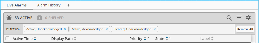

Has anyone had luck changing the background color of the Perspective Alarm Status Table and/or the Alarm Journal Table? In-line styling or applying styling classes don’t seem to work when trying to change the background color.
I saw a relevant forum post and I added this to the base stylesheet.css and it works on portions of the table header, but when I close and reopen my alarm view, the tables revert to their standard gray color. Mileage seems to vary, other devs on their own designers don’t even see the changes.
> .ia\_table\_\_body {
> background-color:#FAFAFA;
> .ia\_table\_\_body\_\_emptyMessage {
Alarm Status Table with above css styling applied
 ![image](https://us1.discourse-cdn.com/inductiveautomation/original/3X/0/4/0460757c5876fc40dc6ccd875e160f630149894c.png)
Alarm Journal Table with above css styling applied
 ![image](https://us1.discourse-cdn.com/inductiveautomation/original/3X/7/6/76c765d7ce5bd1b9716c7faa37b20f5981c3201d.png)
Unfortunately, (1) it doesn’t apply to the whole table and (2) it reverts to the original color the moment I close and reopen the view. Anyone else experience this or know of a fix/workaround? Thanks

Try adding `!important` after the color code to see if it sticks.
**Post date:** [November 22, 2025, 4:52am UTC](https://forum.inductiveautomation.com/t/cant-change-background-color-on-perspective-alarm-status-table/112372/3 "2025-11-22T04:52:53Z")
There are a number of classes you need to override the colour for from memory. Youll need to use dev tools to find them all

I was able to find all the style classes and the ‘!important’ declaration stopped it from reverting.
> background-color: #FAFAFA !important;
> .ia\_alarmTableComponent\_\_toolbar {
> .ia\_alarmTableComponent\_\_toolbar\_\_filter\_\_preFilterContainer {
> .ia\_alarmTableComponent\_\_toolbar\_\_preFilterCount {
> .ia\_alarmTableComponent\_\_toolbar\_\_preFilter\_\_removeAll {
> .ia\_table\_\_headContainer {
> .ia\_alarmTableComponent\_\_foot {
> .ia\_pager {
