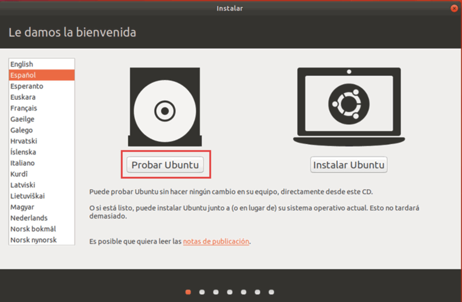

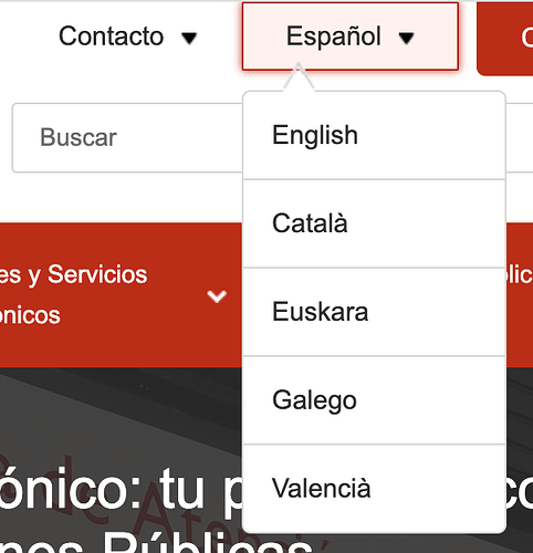

When it comes to UI, that’s governed by style guides, with the aim of consistency. Some sites have dropdown items all in lowercase, some have everything in uppercase eg.
Here’s some screenshots for the word “Español” as they appear for various locale:
**Locale: Spain**
Ubuntu
 ![image](https://us1.discourse-cdn.com/inductiveautomation/original/3X/0/6/06941b8f2d95f00089d256a0034a54d23aa674b0.jpeg)

Spanish Government:
 ![image](https://us1.discourse-cdn.com/inductiveautomation/original/3X/e/f/ef8c1334e77f402a93f383c8be45544c1f5c10b8.png)
[https://administracion.gob.es/](https://administracion.gob.es/)
