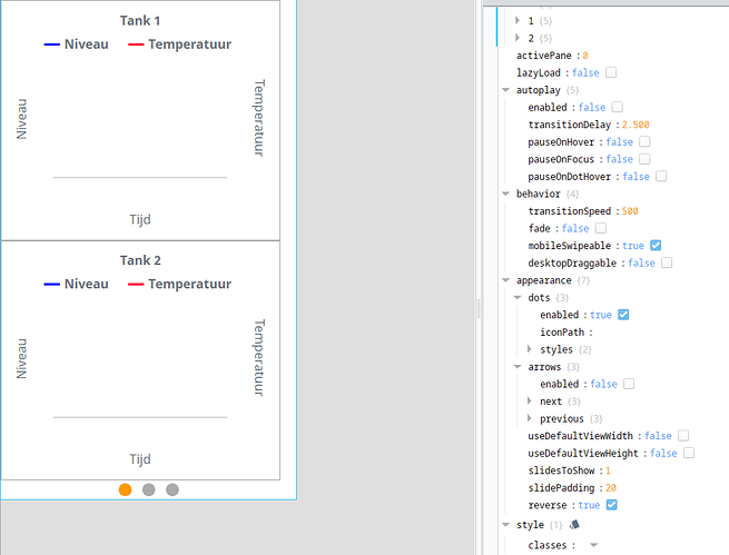

Hi there,
I have a view with only a carousel on it.
I use the carousel without arrows and only the dots enabled.
Also i have set the useDefaultViewWidth and useDefaultViewHeigt to false because I want the carousel to scale the view in the available width.
However is reserves a space on the right of the screen.
If i set the useDefaultViewWidth to true then it does not show the whitespace anymore but also i lose the scaling functionality when opening on another phone as the exact view width is set to.
How can i get rid of the reserved space on the right so it fills about the full width of the page?
I am using ignition version 8.1.0-rc2
 ![image](https://us1.discourse-cdn.com/inductiveautomation/original/3X/b/7/b7c4327484e9db68eb3645143206ac04872392a8.png)
**Author:** ![schenk](https://avatars.discourse-cdn.com/v4/letter/s/6bbea6/32.png) [@schenk](https://forum.inductiveautomation.com/u/schenk)\
**Post date:** [November 9, 2020, 11:12am UTC](https://forum.inductiveautomation.com/t/carrousel-available-space/40439/2 "2020-11-09T11:12:35Z")
Set slidePadding to 0
