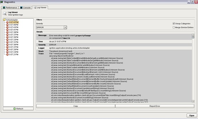

**Author:** ![Tjoeben](https://avatars.discourse-cdn.com/v4/letter/t/6a8cbe/32.png) [@Tjoeben](https://forum.inductiveautomation.com/u/Tjoeben)\
**Post date:** [July 12, 2011, 4:44pm UTC](https://forum.inductiveautomation.com/t/cell-editing-in-a-table-will-not-be-written-to-the-plc/2979/15 "2011-07-12T16:44:20Z")
@Travis,
I place this problem for a while beside me. Now I picked up again.
My script :
[color=#4000FF]
if event.propertyName == “Date”:
headers = [“Licht”, “Burntime”]
data = []
data.append([“Sas”,system.tag.getTagValue(“V41201-V41260/V41231”)])
data.append([“Living achter”,system.tag.getTagValue(“V41201-V41260/V41226”)])
event.source.getComponent(“Tabel34”).data = system.dataset.toDataSet(headers, data)
[/color]
When I run this, next error pop up:
[color=#FF0040]
Traceback (innermost last):
File “event:propertyChange”, line 8, in ?
java.lang.StackOverflowError
[/color]
Even there is no line 8.
And the table “Tabel34” stays empty.
I try different this to solve this problem, but nothing helps.
Do you have any solution ?
Thanks.
**Author:** ![Travis.Cox](https://avatars.discourse-cdn.com/v4/letter/t/b9bd4f/32.png) [@Travis.Cox](https://forum.inductiveautomation.com/u/Travis.Cox)\
**Post date:** [July 13, 2011, 12:25am UTC](https://forum.inductiveautomation.com/t/cell-editing-in-a-table-will-not-be-written-to-the-plc/2979/16 "2011-07-13T00:25:00Z")
Can you post a screenshot of the error? It might be coming from another propertyChange script?
**Post date:** [July 21, 2011, 8:47pm UTC](https://forum.inductiveautomation.com/t/cell-editing-in-a-table-will-not-be-written-to-the-plc/2979/17 "2011-07-21T20:47:24Z")
@Travis,
In the attached file you an see the error.
Thanks.
**Post date:** [July 21, 2011, 9:01pm UTC](https://forum.inductiveautomation.com/t/cell-editing-in-a-table-will-not-be-written-to-the-plc/2979/18 "2011-07-21T21:01:30Z")
There are rare restrictions on this forum to attach a file.
Now I hope the file is arrived ?!
