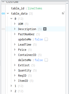

Embedded view parameters:
`column, rowData{}, rowIndex, source (table identifier), value`
`custom.props`:
 ![image](https://us1.discourse-cdn.com/inductiveautomation/original/3X/8/d/8d06491aedb4e382de99d3b569380a3fa9a45100.png)

From your error message, it appears that newValue is a PropertyTreeScriptWrapper$ObjectWrapper type, when you’re expecting it to be numeric. I would try defining the payload inside of the change script on your embedded view instead of sending the view.custom.payload property directly. Otherwise, look into why that newValue is coming in as the wrong datatype.

I discovered why that is happening. The message handler (`recalcExtCost`) is changing the table row object into a `long`. So, I thought I could set the `value` key (marked with number 10):
```python
	rowIndex = int(payload['rowIndex'])
	column = payload['column']
	newValue = payload['newValue']
	rowValue = payload['rowValue']
#	system.perspective.print(column)
	system.perspective.print(newValue)
10	rowValue['value'] = newValue
#	system.perspective.print(rowValue['value'])
	self.custom.table_data[rowIndex][column] = rowValue
	if column == 'Quantity':
		price = self.custom.table_data[rowIndex]['Price']
		quantity = newValue
	elif column == 'Price':
		price = newValue
		quantity = self.custom.table_data[rowIndex]['Quantity']
But, no dice. I am not sure what the next step is.

**Post date:** [October 16, 2025, 1:35am UTC](https://forum.inductiveautomation.com/t/cell-value-change-problem-on-table-with-embedded-views/111488/6 "2025-10-16T01:35:20Z")
Can you share a screenshot of what a row in your data looks like before updating any columns, then after updating one, then after updating the other? So 3 screenshots of the data in total? (by row in your data, I mean the row object in the property editor)
I think what’s happening is that the data is originally nested, but when you’re writing it back it isn’t nested in the same way.
From `{u'display': True, u'action': u'update', u'style': {}, u'value': 40.0, u'enabled': True}`
Probably to whatever value you’re entering, like `1`
So when you write to your data, make sure you write to the [“value”] key instead of the entire column object.

Here is the code for the screenshots demo:

Before changing either cell value:
 ![image](https://us1.discourse-cdn.com/inductiveautomation/original/3X/0/2/02614e10a778e63c792478e91a1f0acf44dfd90e.png)
After changing Quantity:

**Author:** ![danieltalbot](https://sea1.discourse-cdn.com/inductiveautomation/user_avatar/forum.inductiveautomation.com/danieltalbot/32/11201_2.png) [@danieltalbot](https://forum.inductiveautomation.com/u/danieltalbot)\
**Post date:** [October 16, 2025, 6:23pm UTC](https://forum.inductiveautomation.com/t/cell-value-change-problem-on-table-with-embedded-views/111488/9 "2025-10-16T18:23:47Z")
try this instead:
self.custom.table\_data[rowIndex][column][“value”] = rowValue
See how after changing the value for Price or Quantity, the row object in property editor goes from an object {5} to a value?
