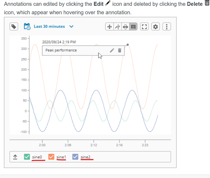

Hello, I'am usinf PowerChart but I can't found where I can change color of Tagname
 ![image](https://us1.discourse-cdn.com/inductiveautomation/original/3X/a/d/ad991a76cec08a40240c4ed0b1419055fdcaf285.png)
