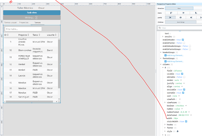

**Author:** ![OscarLucas](https://sea1.discourse-cdn.com/inductiveautomation/user_avatar/forum.inductiveautomation.com/oscarlucas/32/6417_2.png) [@OscarLucas](https://forum.inductiveautomation.com/u/OscarLucas)\
**Post date:** [February 25, 2021, 12:07pm UTC](https://forum.inductiveautomation.com/t/change-column-width-of-table-in-perspective/27059/10 "2021-02-25T12:07:55Z")
Dear cmallonee,
I don’t know what do not change the width.
Can you help me?
 ![image](https://us1.discourse-cdn.com/inductiveautomation/original/3X/a/3/a33708ae026b48642b8710b2c3366499a82fd199.png)
**Author:** ![cmallonee](https://sea1.discourse-cdn.com/inductiveautomation/user_avatar/forum.inductiveautomation.com/cmallonee/32/6416_2.png) [@cmallonee](https://forum.inductiveautomation.com/u/cmallonee)\
**Post date:** [February 25, 2021, 3:36pm UTC](https://forum.inductiveautomation.com/t/change-column-width-of-table-in-perspective/27059/11 "2021-02-25T15:36:26Z")
Remove the “px” from “50px”.
