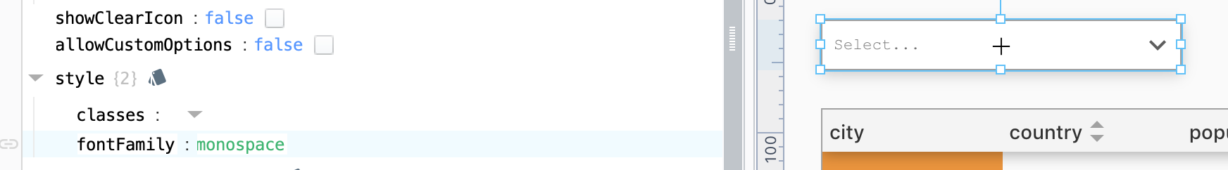

It depends on what version youre using, as before 8.0.13 there were many probelms with setting the font of the Dropdown, and the DateTime Picker didn’t allow it at all if I recall correctly.
As of 8.0.13 (still in RC), you can set `Dropdown.style.fontFamily` to the font you’d like:

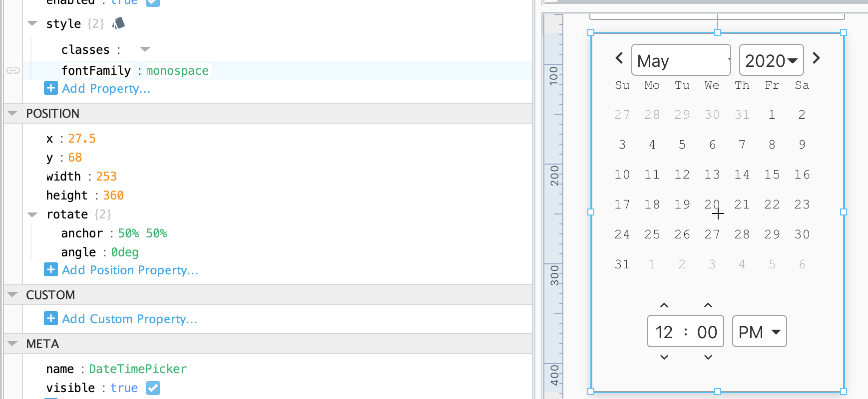

The DateTime Picker currently has a bug which prevents modifying the text in the Dropdowns, although the text of the calendar itself may be modified with the same property setting as the Dropdown.
