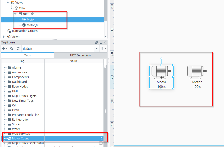

Hi Everyone,
How to make the number of objects (motor component) increase with the tag value in perspective. I have added an image for reference. I need to link the motor objects with the value of the tag.
 ![image](https://us1.discourse-cdn.com/inductiveautomation/original/3X/9/5/95b3c9d98bcc131275c39ef55f10180e5caa1641.png)
**Post date:** [February 5, 2024, 5:31pm UTC](https://forum.inductiveautomation.com/t/change-the-count-of-objects-in-perspective-using-integer-tag/85239/2 "2024-02-05T17:31:02Z")
Create a view with one motor and set parameters on the view.
Then use the Flex Repeater component to create as many instances as you require.
[https://docs.inductiveautomation.com/display/DOC81/Perspective+-+Flex+Repeater](https://docs.inductiveautomation.com/display/DOC81/Perspective+-+Flex+Repeater)
