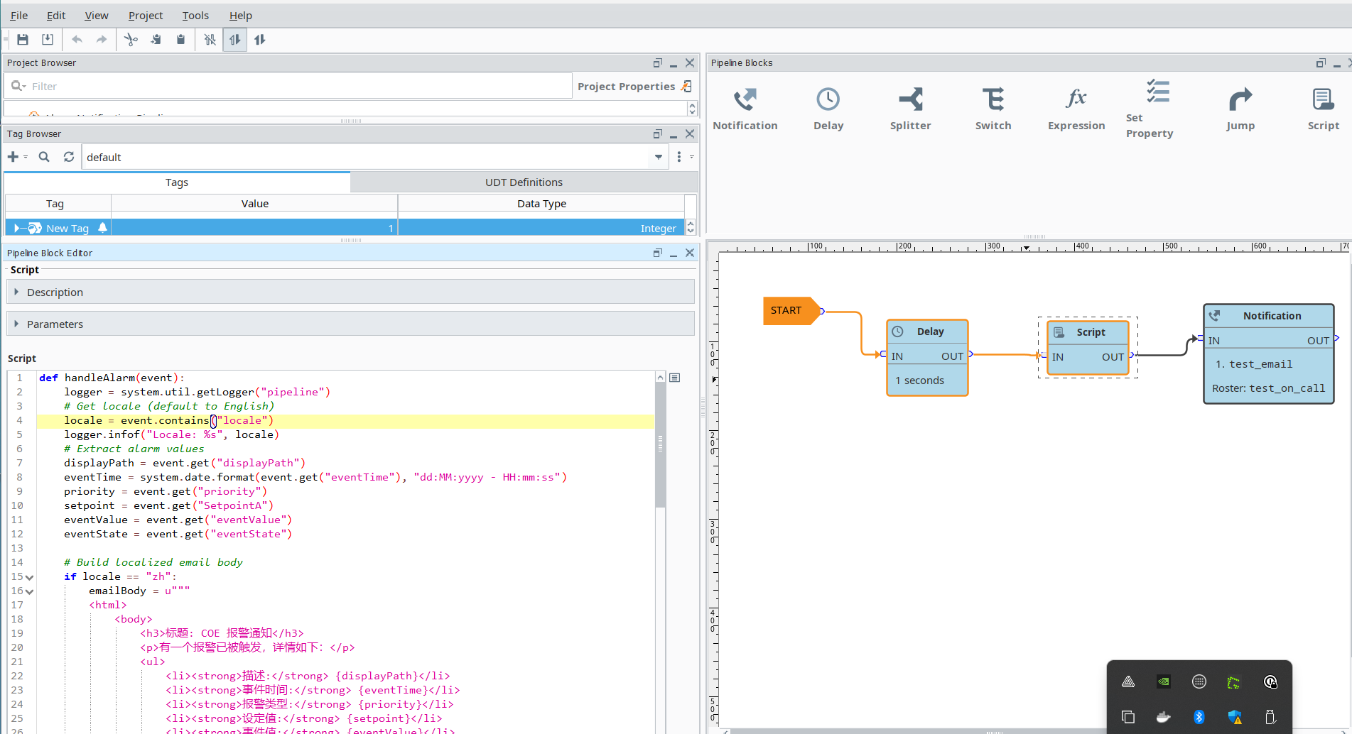

Change the email language in the email pipeline from English to Chinese based on the selected language.
I have added a script before the alarm notification block and written the script below.

After that, I have added the notification pipeline. In the notification pipeline message section, I passed the parameter `{emailBody}`
 ![22](https://us1.discourse-cdn.com/inductiveautomation/original/3X/7/f/7f4906156b7dd3a5344f3d3faab8506dc42d1562.png)
 ![222](https://us1.discourse-cdn.com/inductiveautomation/original/3X/0/d/0dcd5dec3494d6cd9521d8de3110a847f304e1f3.png)
 ![456](https://us1.discourse-cdn.com/inductiveautomation/original/3X/6/4/6475162487bf371d473e15584770509420d8cf6c.png)
Now, my email is sent, but it passes NULL data. If I remove the script and pass the message in HTML format, it sends the message accurately. However, we require the message in multiple languages. What can I do?

**Author:** ![Marcus\_Sysum](https://sea1.discourse-cdn.com/inductiveautomation/user_avatar/forum.inductiveautomation.com/marcus_sysum/32/57944_2.png) [@Marcus\_Sysum](https://forum.inductiveautomation.com/u/Marcus_Sysum)\
**Post date:** [April 23, 2025, 7:37pm UTC](https://forum.inductiveautomation.com/t/change-the-email-language-in-the-email-pipeline-from-english-to-chinese-based-on-the-selected-language/105418/4 "2025-04-23T19:37:09Z")
in your script pipelineVars is local to this script so the email notification block does not have access to this. Try setting the email Body like this `event.setGlobal("emailBody", emailBody)` Then in your notification block you can reference the email body like above as `{emailBody}`

> [@Marcus\_Sysum](#):
Can you please check the script I shared in the chat? When I added it again, I received a null message. Could you please assist me with this?
**Post date:** [April 24, 2025, 2:09pm UTC](https://forum.inductiveautomation.com/t/change-the-email-language-in-the-email-pipeline-from-english-to-chinese-based-on-the-selected-language/105418/9 "2025-04-24T14:09:12Z")
Have you checked the gateway logs for errors? I did a simple test with this code and there are many errors. Which is why the **whole notification returns null**.
Are you running this inside the actual script block in the pipeline?
Like this.
 ![image](https://us1.discourse-cdn.com/inductiveautomation/original/3X/1/9/199f6a2ab6733813efe80397b060f540df67bfca.png)
In your script you have **alarmEvent.get()** which is not valid its **event.get()** with only one argument. When using it in the pipeline scripting block
Locale is not valid parameter in the event object unless you are passing it in somewhere else. I am not sure the full context of this script.
Here below is what I tested

This Code generates the html and passes it correctly but locale is always null as it doesn't exist.
Check your gateway logs for errors. If you want to chek if something exists in the event object you can use the `event.contains()` method. `event.contains('locale')` returns false. In my case because it is never exists.
**Post date:** [April 25, 2025, 1:27pm UTC](https://forum.inductiveautomation.com/t/change-the-email-language-in-the-email-pipeline-from-english-to-chinese-based-on-the-selected-language/105418/11 "2025-04-25T13:27:58Z")
If your force label to equal zh in the script you will see the alternate language. I had done this in my test. The loggers in place should show you what is being passed into the label. If you you still need assistance then please reach out to support.
[https://support.inductiveautomation.com/hc/en-us](https://support.inductiveautomation.com/hc/en-us)
**Author:** ![abhijit.jagtap](https://avatars.discourse-cdn.com/v4/letter/a/3bc359/32.png) [@abhijit.jagtap](https://forum.inductiveautomation.com/u/abhijit.jagtap)\
**Post date:** [April 25, 2025, 2:03pm UTC](https://forum.inductiveautomation.com/t/change-the-email-language-in-the-email-pipeline-from-english-to-chinese-based-on-the-selected-language/105418/12 "2025-04-25T14:03:25Z")
![mail](https://us1.discourse-cdn.com/inductiveautomation/original/3X/f/a/fac0f2181ba0fa66280db831e20f6c04e5ef3c3f.png)
Hello.
Know I have tried with below code as per you said tried with label = "zh"
then I have received attached mail format.
can you have any demo for entire email translation. If you have, please send me.
I am available now if get small session.
**Post date:** [April 25, 2025, 2:14pm UTC](https://forum.inductiveautomation.com/t/change-the-email-language-in-the-email-pipeline-from-english-to-chinese-based-on-the-selected-language/105418/13 "2025-04-25T14:14:33Z")
Hi,
I have done some R&D and created two email profiles. If the selected language is "zh", profile 1 sends the email, and if "en" is selected, profile 2 sends the email.
However, in this case, the description of alarm, alarm type, and transitioned state are not translated into Chinese, although all the other data is correctly translated.
I did not use any script block in this case.
I have attached a snapshot for your reference.
 ![mail1](https://us1.discourse-cdn.com/inductiveautomation/original/3X/9/0/90aefd590aec1a69a547bcef80c6d31f5fd4c70f.png)
 ![mail2](https://us1.discourse-cdn.com/inductiveautomation/original/3X/a/1/a1d837e00399cfaa48b9cd1ac4940864f58d0a38.png)
