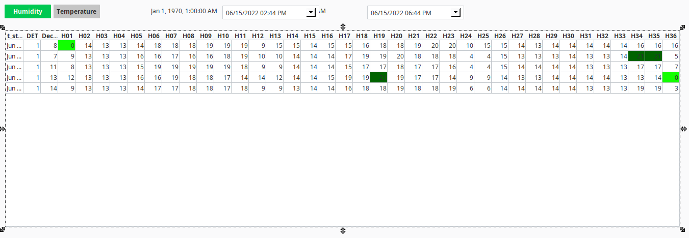

**Author:** ![prasath.t](https://avatars.discourse-cdn.com/v4/letter/p/898d66/32.png) [@prasath.t](https://forum.inductiveautomation.com/u/prasath.t)\
**Post date:** [June 16, 2022, 3:27pm UTC](https://forum.inductiveautomation.com/t/change-the-table-cell-color-based-on-value/60604/18 "2022-06-16T15:27:07Z")
> [@dkhayes117](#):
> ```python
> H02 = int(self.data.getValueAt(row,"H02"))
> if H02 < 1:
> color = "11ff00"
> elif H02 < 16:
> color = "ff%s00" % hex(17 * H02)
> elif H02 < 30:
> color = "%sff00" % hex(17 * (30-H02))
> else:
> color = "ff1100"
> return system.gui.color(color)
**script is not working**. Example image i have attached which i got from wincc report
 ![image](https://us1.discourse-cdn.com/inductiveautomation/original/3X/f/d/fd3bf70172d357bdd727743ae2836ac9f00439ff.png)
**Author:** ![dkhayes117](https://sea1.discourse-cdn.com/inductiveautomation/user_avatar/forum.inductiveautomation.com/dkhayes117/32/68344_2.png) [@dkhayes117](https://forum.inductiveautomation.com/u/dkhayes117)\
**Post date:** [June 16, 2022, 3:56pm UTC](https://forum.inductiveautomation.com/t/change-the-table-cell-color-based-on-value/60604/19 "2022-06-16T15:56:07Z")
You didn’t provide enough context in order for me to give you the correct answer. My script was only looking at H02 for every row, _ **based on what you provided** _…
```auto
value = int(value)
if value < 1:
	color = "11ff00"
elif value < 16:
	color = "ff%s00" % hex(17 * value )
elif value < 30:
	color = "%sff00" % hex(17 * (30-value ))
else:
	color = "ff1100"
**Post date:** [June 16, 2022, 6:19pm UTC](https://forum.inductiveautomation.com/t/change-the-table-cell-color-based-on-value/60604/20 "2022-06-16T18:19:41Z")
> [@dkhayes117](#):
> ```python
> value = int(value)
> if value < 1:
> color = "11ff00"
> elif value < 16:
> elif value < 30:
> else:
> color = "ff1100"
used your code but **color is applying for few numbers only**. **Main thing is freezing the client i couldn't able to access the window**. Is there any way to run the script without freezing client?
 ![image](https://us1.discourse-cdn.com/inductiveautomation/original/3X/7/c/7c2190e82bddd6662302b8e9559707dd9f4e56d2.png)
**Post date:** [June 16, 2022, 6:42pm UTC](https://forum.inductiveautomation.com/t/change-the-table-cell-color-based-on-value/60604/21 "2022-06-16T18:42:07Z")
The hex portion of the code is adding the `0x` prefix to the number which throws off the color translation. There is most certainly a better way to fix that, but without researching it, this will fix it.
```auto
	value = int(value)
	if value < 1:
		color = "11ff00"
	elif value < 16:
		color = "ff%s00" % hex(17 * value).replace("0x","")
	elif value < 30:
		color = "%sff00" % hex(17 * (30-value)).replace("0x","")
	else:
		color = "ff1100"
