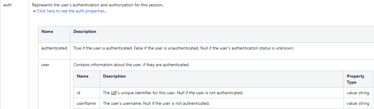

For Perspective, can’t you use the [session properties](https://docs.inductiveautomation.com/display/DOC80/Session+Properties) to get the user name?
 ![image](https://us1.discourse-cdn.com/inductiveautomation/original/3X/1/c/1ca4d1e1318c5566e22b7905e4ec72572c13bd5c.png)
As for the vision side, I’m not sure that you will be able to do exactly what you described there. You can use the filterRoster extension function in the Roster Management object to show just the rosters the logged in user is in but I’m not sure if you’ll be able to custom script it with built in script function.

Thank you! So, that solved my Perspective issues by adding this:
```auto
# Get username
self.session.props.auth.user.userName
I was looking for an API call, and hadn’t looked through the properties.
