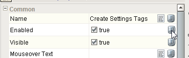

**Author:** ![Sanderd17](https://sea1.discourse-cdn.com/inductiveautomation/user_avatar/forum.inductiveautomation.com/sanderd17/32/8735_2.png) [@Sanderd17](https://forum.inductiveautomation.com/u/Sanderd17)\
**Post date:** [March 5, 2018, 12:36pm UTC](https://forum.inductiveautomation.com/t/changing-client-permissions-during-run-time/17179/13 "2018-03-05T12:36:54Z")
Maybe it would be a good idea to read through the documentation and follow the tutorials. But anyway …

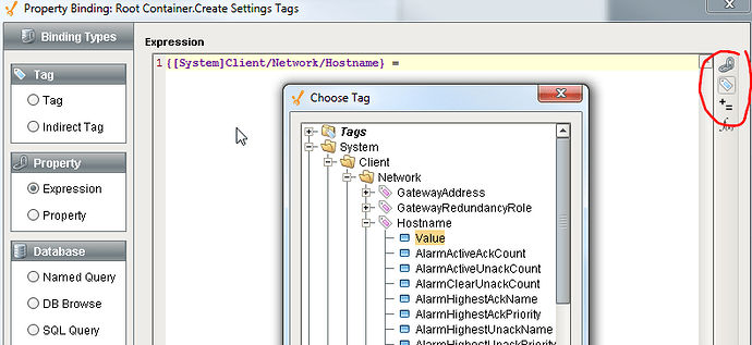

On a component, you can bind the “enabled” property by clicking on that linking icon on the right side.
![](https://us1.discourse-cdn.com/inductiveautomation/original/2X/6/69f28339ac929dd0f63d2876bde91400d9acffad.png)
On that popup, choose the expression binding, and browse for the tags you want (you want to compare the client hostname to that tag you defined in step 1).
 ![](https://us1.discourse-cdn.com/inductiveautomation/original/2X/0/054471137bda67dda04b53f7f90b582a91165f2a.png)
Expression bindings have their own syntax, and are different from scripting.

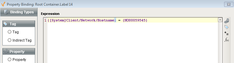

**Author:** ![carolineuchoa.estuda](https://avatars.discourse-cdn.com/v4/letter/c/ba8739/32.png) [@carolineuchoa.estuda](https://forum.inductiveautomation.com/u/carolineuchoa.estuda)\
**Post date:** [March 5, 2018, 1:03pm UTC](https://forum.inductiveautomation.com/t/changing-client-permissions-during-run-time/17179/14 "2018-03-05T13:03:44Z")
![](https://us1.discourse-cdn.com/inductiveautomation/original/2X/5/5f1e980c651dbaf91d06625b96a4ec8922d1141d.png)
Ok now? 😃

No, you should have one tag holding the hostname that is allowed to write.
Then the teacher/administrator can set that tag (probably via a separate interface), and the comparison will make sure that only the selected hostname can write to the tag.
