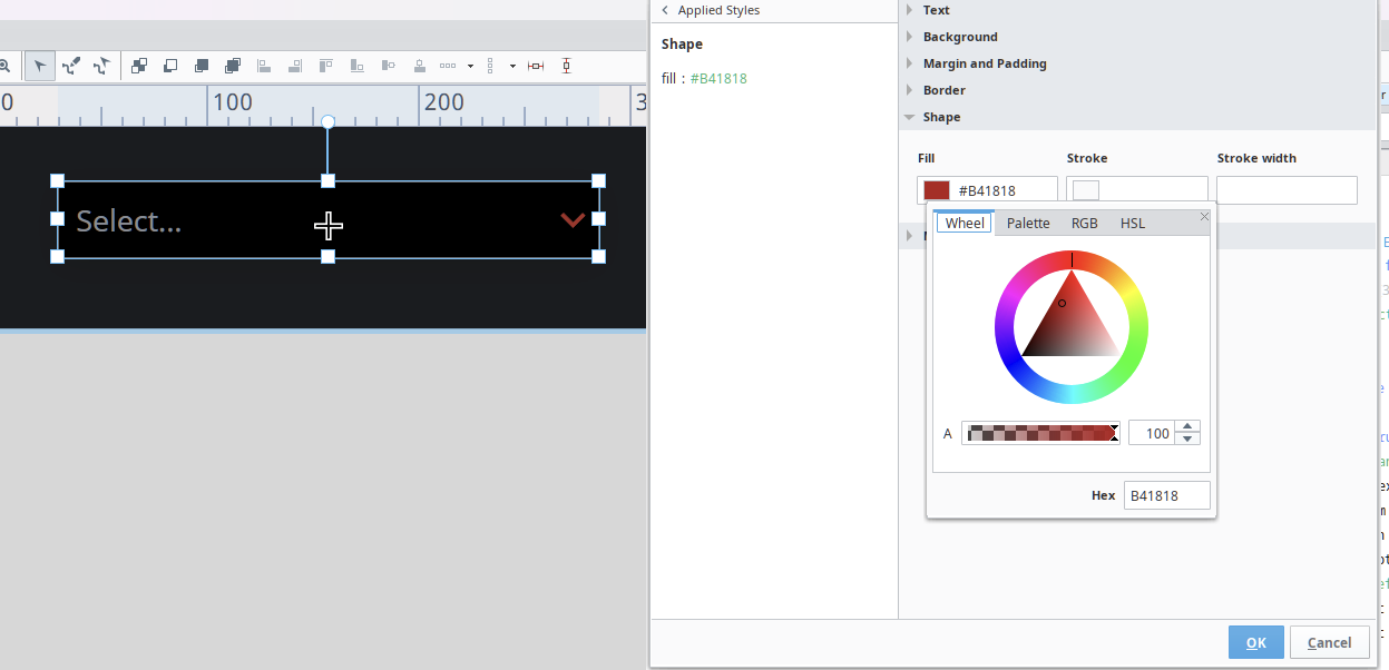

**Author:** ![Jacob\_Dipietro](https://avatars.discourse-cdn.com/v4/letter/j/82dd89/32.png) [@Jacob\_Dipietro](https://forum.inductiveautomation.com/u/Jacob_Dipietro)\
**Post date:** [August 22, 2025, 3:45pm UTC](https://forum.inductiveautomation.com/t/changing-color-of-dropdown/110008/2 "2025-08-22T15:45:32Z")
Hello!
You can change the arrow color by changing the Shape Fill or Stroke in the style options.
 ![image](https://us1.discourse-cdn.com/inductiveautomation/original/3X/4/8/4856b5654fe7bbcd0d0f961bc21943a97003c323.png)
