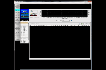

**Post date:** [December 2, 2011, 2:37pm UTC](https://forum.inductiveautomation.com/t/charging-window/3690/2 "2011-12-02T14:37:36Z")
You mean besides the progress circle in the upper right corner?
 ![](https://us1.discourse-cdn.com/inductiveautomation/original/1X/8943a3df39e6e01bdff4759c5f9c40d50b2354f6.gif)

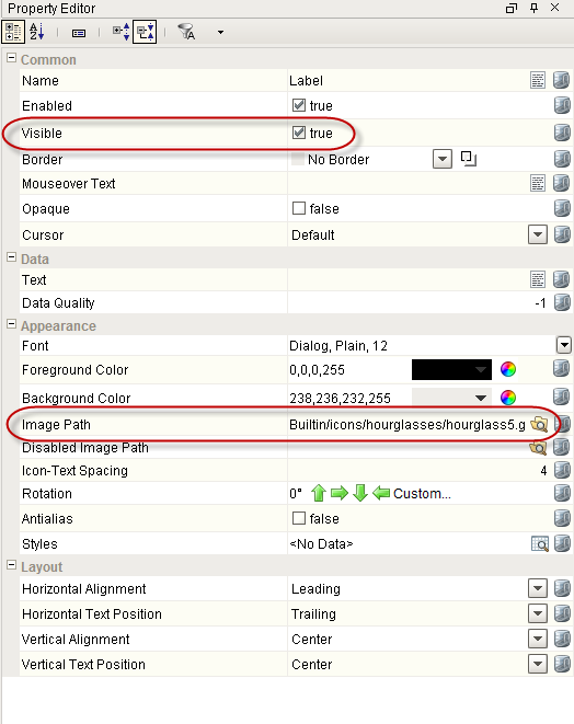

**Author:** ![SamJaimes](https://avatars.discourse-cdn.com/v4/letter/s/a6a055/32.png) [@SamJaimes](https://forum.inductiveautomation.com/u/SamJaimes)\
**Post date:** [December 14, 2011, 11:43am UTC](https://forum.inductiveautomation.com/t/charging-window/3690/8 "2011-12-14T11:43:54Z")
How can I activated? I mean, there’s not any property that I can use to activate the image
Thanks!
**Post date:** [December 14, 2011, 11:46am UTC](https://forum.inductiveautomation.com/t/charging-window/3690/9 "2011-12-14T11:46:35Z")
Put them in a label component and use the visible property on the label. 🙂
 ![](https://us1.discourse-cdn.com/inductiveautomation/original/1X/c4e6afc6d56516189a6c236c622f16b5e447a99d.png)
