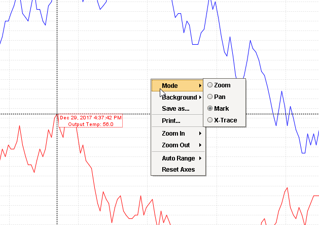

I noticed something tho, might be a bug but if you setMode to say X-Trace on window open, it will be set on X-trace but if you right click and select Mode it shows “Zoom” being selected so to get zoom you have to select some other Mode first then select zoom again. is this just happening to me?

**Post date:** [January 5, 2018, 4:40pm UTC](https://forum.inductiveautomation.com/t/chart-mode-via-scripting/16452/8 "2018-01-05T16:40:17Z")
What version are you on? In Ignition 7.9.5 I add a `setMode()` to the `visionWindowOpened` event handler, and when I open my popup window it’s in the proper mode on the popup menu:

maybe it’s fixed then, I’m on 7.9.4
**Author:** ![albetro.15](https://sea1.discourse-cdn.com/inductiveautomation/user_avatar/forum.inductiveautomation.com/albetro.15/32/3922_2.png) [@albetro.15](https://forum.inductiveautomation.com/u/albetro.15)\
**Post date:** [January 5, 2018, 5:11pm UTC](https://forum.inductiveautomation.com/t/chart-mode-via-scripting/16452/10 "2018-01-05T17:11:38Z")
I too tested it in version 7.9.5 and this bug doesnt appear. It seems it was effectively fixed in the update.
