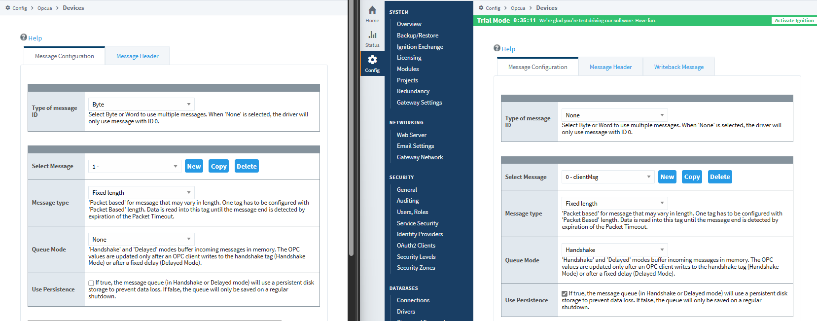

Using generic TCP Driver module that Chi created, is the TCP Server driver supposed to allow a writeback message? I thought it did, and I have a tag that shows I was able to set this up once, but I can’t recreate that tag. When I go back to re-create a new TCP server it’s not showing that Writeback Message tab on any of the server definitions.
Tag that shows Writeback for a server definition and is valid
 ![image](https://us1.discourse-cdn.com/inductiveautomation/original/3X/b/3/b327ede244d84cf9dd03cf0d0d9f47426b89db1f.png)
Side by side of a server config page and a client config page. I know they can be different; the image is for a reference of what I’m seeing on the Server config to point out I’m missing that Writeback Message tab (assuming it should be there).
 ![image](https://us1.discourse-cdn.com/inductiveautomation/original/3X/3/9/39a246e3e6b84ce78daaa1bcb4713fc1d8a63068.png)
Thanks in advance!

Is there a device list configured? Writeback is not possible when ‘accept all connections’ is checked.

At the time of my question, there was not. That was definitely something I overlooked in your documentation. I probably had a device configured within the device list at one point and then removed it during testing. Thank you for the reply and clarification!
