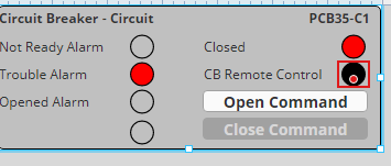

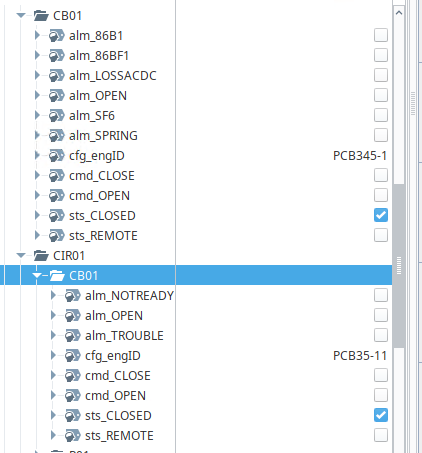

Hi all,
I want to auto populate a pop up for a circuit breaker. When the tag path is passed over I want to populate the pop up with the different alarms/status shown in the images.
Each circuit breaker has different tags which would be the best way to do this?
![image](https://us1.discourse-cdn.com/inductiveautomation/original/3X/b/0/b0f6c4f5596fd7daa2993c140f41e0e9dbed82b8.png)
![image](https://us1.discourse-cdn.com/inductiveautomation/original/3X/b/4/b480fb5cfc5b28798790fb35633d6ef1be72599d.png)
**Author:** ![pascal.fragnoud](https://sea1.discourse-cdn.com/inductiveautomation/user_avatar/forum.inductiveautomation.com/pascal.fragnoud/32/24728_2.png) [@pascal.fragnoud](https://forum.inductiveautomation.com/u/pascal.fragnoud)\
**Post date:** [July 18, 2022, 10:59am UTC](https://forum.inductiveautomation.com/t/circuit-breaker-pop-up/61996/2 "2022-07-18T10:59:09Z")
I’d put a flex repeater in the popup view, then in the script that opens the popup, read all your tags, create an array containing a label and the tag’s value, pass those to the pop up’s view and use them as instances of the flex repeater.
That way you can read all your tags in one call, and the popup’s view is only in charge of displaying things.
