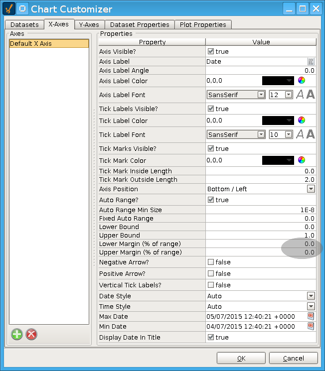

Hi All,
I’ve got a Chart component and populated it with data. That all works well.
The problem is, there is a Gap on the left side of the chart before the data starts and a gap on the right side after the data ends. Is there any way to have the range of the chart match exactly the time period of the data so there are no gaps?
 ![](https://us1.discourse-cdn.com/inductiveautomation/original/2X/d/d533144b70f68646f4fb6fa8f152fbab270f051f.png)
**Post date:** [May 7, 2015, 1:01pm UTC](https://forum.inductiveautomation.com/t/classic-chart-gaps/9990/2 "2015-05-07T13:01:20Z")
In the chart customizer, go to the X-Axes tab and select your axis. Find the “Lower Margin” and “Upper Margin” properties and set them to zero, as shown here:
 ![](https://us1.discourse-cdn.com/inductiveautomation/original/2X/3/3baf96c35c3d736e8ae329e02f97f6dfbe2117bb.png)

Awesome!
Thanks pturmel
