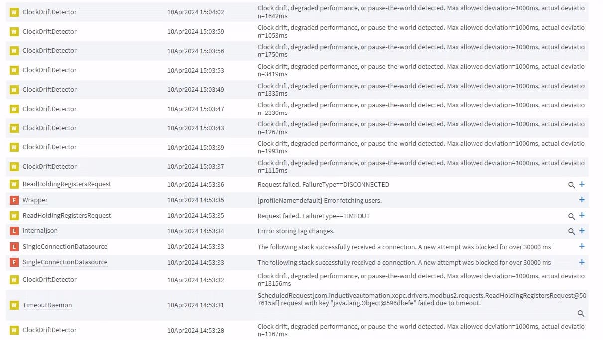

Hello,
I have Ignition Edge 8.1.37 running on a Raspberry PI using Ubuntu 22.04.4 LTS. Ever so often, Clock drift warnings appear in the logs which often follow with higher CPU and Memory usage. This, in turn, can start a snowball of problems that bogs down the gateway and gives tremendous performance issues with data loss. My usual solution is to reboot Raspberry PI which clears up the Clock Drift warnings and sets the gateway running normally.
This brings up the following questions:
1. What causes these seemingly random clock drifts, and can they be mitigated?
2. Is there a way to send a tag or alarm for a Clock Drift Warning?
3. Is this purely a system issue that I need to address strictly on the local machine?
I've attached some images of the logs and system performance from the gateway.
 ![Logs (1).PNG](https://us1.discourse-cdn.com/inductiveautomation/original/3X/7/2/72272eb68b560f828ad5d94bc49034a2989621a4.jpeg)
 ![Performance Stats](https://us1.discourse-cdn.com/inductiveautomation/original/3X/4/6/464916a5a9b3259d68000706341d81204e1bae44.png)
It looks like issues started occurring yesterday around 14:53 which resulted in blanks in the memory and CPU usage.
Thanks for any help on this!

> [@Andrew\_Harper](#):
Typically, it is a severe memory issue with a garbage collection stall. You have a gap in your memory plot that could correspond to a memory spike.
But, it can also be a CPU hog **outside Ignition** running on the same machine. Running a database on the same machine is often a culprit, especially in underpowered systems.
There is no way to send an alarm for these--though an external process that watches the wrapper log might be able to help.
The close spacing of these events in your log suggest that some other process on the machine was bogging you down.

**Post date:** [April 11, 2024, 5:54pm UTC](https://forum.inductiveautomation.com/t/clock-drift-warnings-on-raspberry-pi/88695/6 "2024-04-11T17:54:22Z")
Right. You could monitor the wrapper log externally, or perhaps use logback's configuration to filter in some other manner.
You could also run your own detector as a timer event with a fixed pace, and monitor the timestamps you get within that event.
