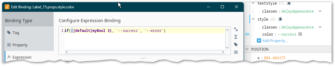

I am trying to change the color of the text on a label depending on the value of the tag. I am pulling in the tag from a PLC and applying a python script to it, the tag is either 1 or 0. Right now my python script is putting GOOD or BAD on the label depending on if the tag is 1 or 0. I would also like it to change the color of the text to green if GOOD (1) or red if BAD (0).
Is this possible to do through the python script?

Expression for GOOD / BAD on the label's `PROPS.text`:
`if({[default]MyBooleanTag}, "GOOD", "BAD")`
Expression for label color:
- Add a color property to `PROPS.style`.
 ![image](https://us1.discourse-cdn.com/inductiveautomation/original/3X/c/2/c284942d28bc4f564cb4aaf1751befe0c5ce2641.png)
Expression:
`if({[default]MyBooleanTag}, '--success', '--error')`
This also introduces you to [Perspective Built-In Themes | Ignition User Manual](https://docs.inductiveautomation.com/docs/8.1/ignition-modules/perspective/styles/perspective-built-in-themes) which is the way of the web. You should use built-in or your own theme colors rather than hard-coding colors in your application. That is fundamental to separation of content and style.

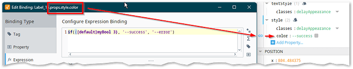

**Author:** ![bshriner](https://avatars.discourse-cdn.com/v4/letter/b/46a35a/32.png) [@bshriner](https://forum.inductiveautomation.com/u/bshriner)\
**Post date:** [September 17, 2025, 3:53pm UTC](https://forum.inductiveautomation.com/t/color-conditional-formatting-on-a-label/110718/7 "2025-09-17T15:53:40Z")
I think this is the best method for what I am trying to do. I have some questions still though.
1. Am I able to apply both of these expressions at the same time? Im assuming I just add the color one on another line?
2. When I try to do the color change expression you provided it just changes my label to ‘–success’ or ‘–error’ if({[default]_LeakTesting-PLC_/TestResults}, '--success', '--error')
**Post date:** [September 17, 2025, 4:00pm UTC](https://forum.inductiveautomation.com/t/color-conditional-formatting-on-a-label/110718/8 "2025-09-17T16:00:54Z")
You need two bindings (three, if you go the recommended way above).
One on the text property of the label, returning 'good' or 'bad'.
One on the style classes property, returning which style class or color to use (`--success` or `--error`)
Optionally, one on a custom property bound to the tag that just returns a boolean.

**Post date:** [September 17, 2025, 4:15pm UTC](https://forum.inductiveautomation.com/t/color-conditional-formatting-on-a-label/110718/9 "2025-09-17T16:15:36Z")
Yes, but not on the same property. One binding max on each property.
> 1. When I try to do the color change expression you provided it just changes my label to ‘–success’ or ‘–error’ if({[default]_LeakTesting-PLC_/TestResults}, '--success', '--error')
You've applied the color binding to `PROPS.text.`. You need to add it to `PROPS.style.color` which you will have created if you used my instructions in post #3.
 ![image](https://us1.discourse-cdn.com/inductiveautomation/original/3X/1/b/1b6808e189a24fe457bd75b45014dd82e73b911e.png)
**Post date:** [September 17, 2025, 4:55pm UTC](https://forum.inductiveautomation.com/t/color-conditional-formatting-on-a-label/110718/10 "2025-09-17T16:55:08Z")
I got it now. Thank you!
