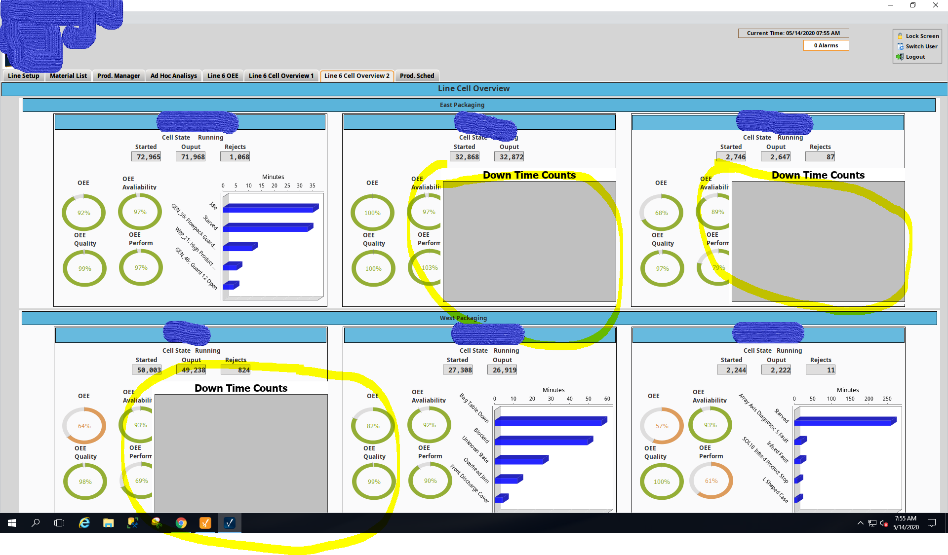

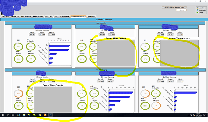

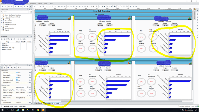

I have an OEE Production bar chart on a vision screen. The chart shows good data while in the designer (Bar Chart 1), but when the client is launched, shows no data (Bar Chart 2). I have checked against the bar charts that work in both sessions and I don’t see a difference. No error codes on the property editor. I don’t see any error codes in the designer log.No errors pertaining to the bar charts when the client is launched

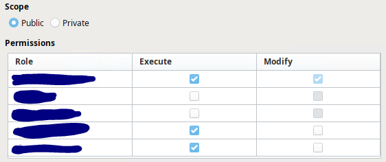

Looks like you’re using the Sepasoft Modules. Have you given access to those analysis settings for the user/role that’s logged in on the client?
I.e.

Yes, I just found that. The displays work when I am logged in as an administrator. Now they work for both. Thanks for helping me out.
