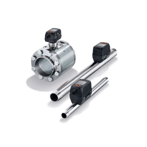

Another possible alternative is IFM’s SD series. We’ve used their pressure sensors extensively.
> **[Flow meter for compressed air and industrial gas - ifm](https://www.ifm.com/us/en/category/200_020_030_020_010#/best/1/100)**
> Flow meter for compressed air & industrial gases ✓ Three-in-one sensors ✓ 50+ years' experience ✓ 5-Year Product Warranty ✓90% Of Orders Shipped in 1 Hour
They also make I/O-Link masters that support a lot of protocols (MQTT, Modbus TCP, Profinet, E/IP, etc), so those can be connected to directly by Ignition.
